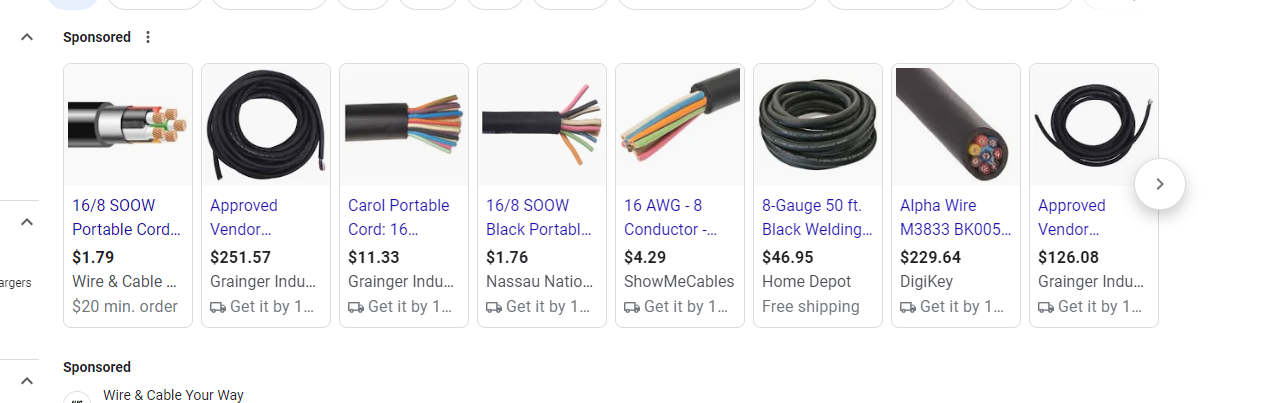

If possible, I replace exposed wiring with an appropriately-sized SO cord.
As an example, I recently made a new harness for the tourpack on my Harley. The harness needed to have 6 different conductors; ground, power, switched power, brake light, & turn signals.
I used a length of 16-8 SO cord:
This option works great, so long as you can make good electrical connections that retain the weatherproof properties of the cable - which isn't always possible.
