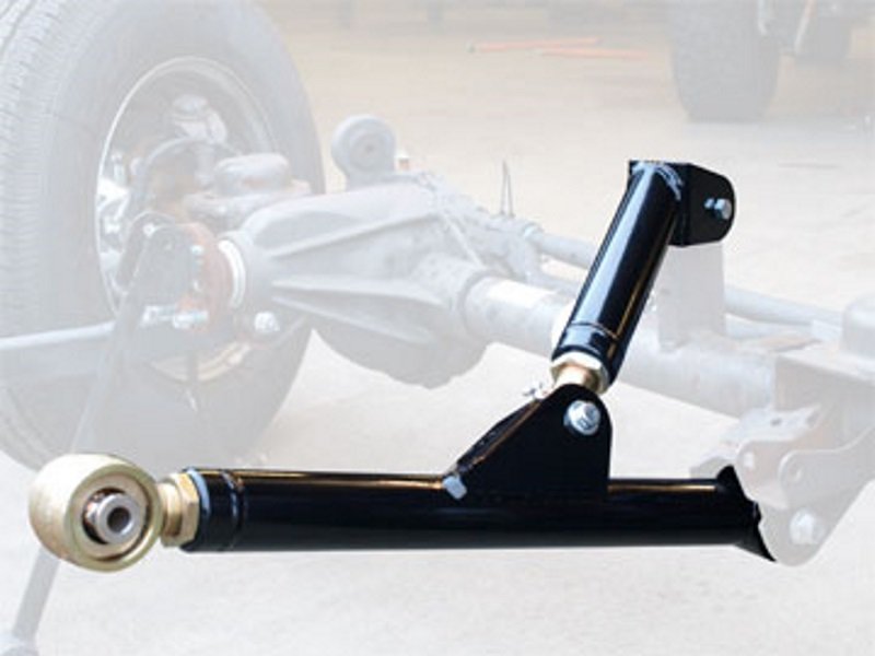

Adjustable Upper and Lower Control Arms
Adjustable upper and lower control arms allow you to adjust castor. The factory control arms are non-adjustable. After installing a lift (generally over 3") the front caster angles may become more negative, creating a "flighty" feeling. This is countered by increasing the castor in the positive direction to increase vehicle stability.

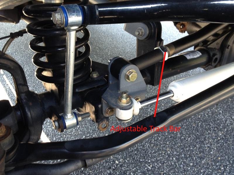

Adjustable Trackbar
When you install a suspension lift on your JK in excess of three inches, a lot of the suspension geometry changes. One of these is the horizontal position of the axle. An adjustable trackbar is needed because the factory trackbar is too short to keep the axle centered. Instead, it moves the axle to the side to keep the distance between the axle and track bar equal.

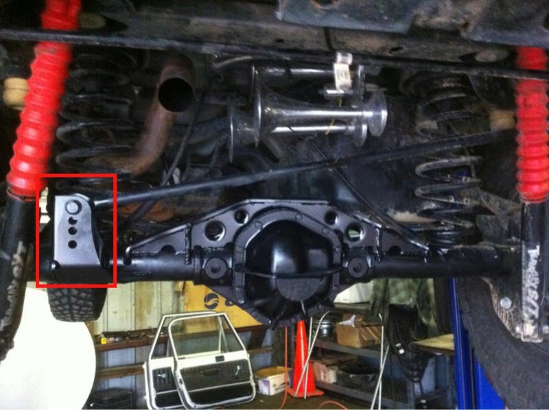

Rear Track Bar Mount
Instead of installing an adjustable track bar for the rear, some companies provide a new track bar mount. This relocates the rear track bar to maintain factory position of the rear axle.

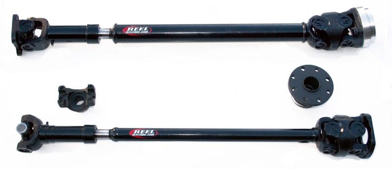

Driveshaft
Once your JK exceeds four inches of suspension lift, you may need a modified driveshaft to maintain factory-like universal joint angles. Although a modified driveshaft is usually not required or included with a suspension lift installation kit, damage to the factory driveshaft and differentials can occur once the universal joints reach their maximum working angle.

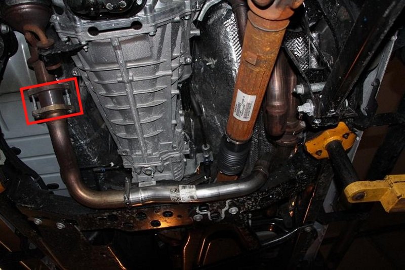

Exhaust Spacers
Once your lift exceeds 2.5 inches to 3 inches, you may need exhaust spacers. These move the exhaust crossover pipe further back, creating more clearance between the exhaust and front drive shaft/crossmember.
