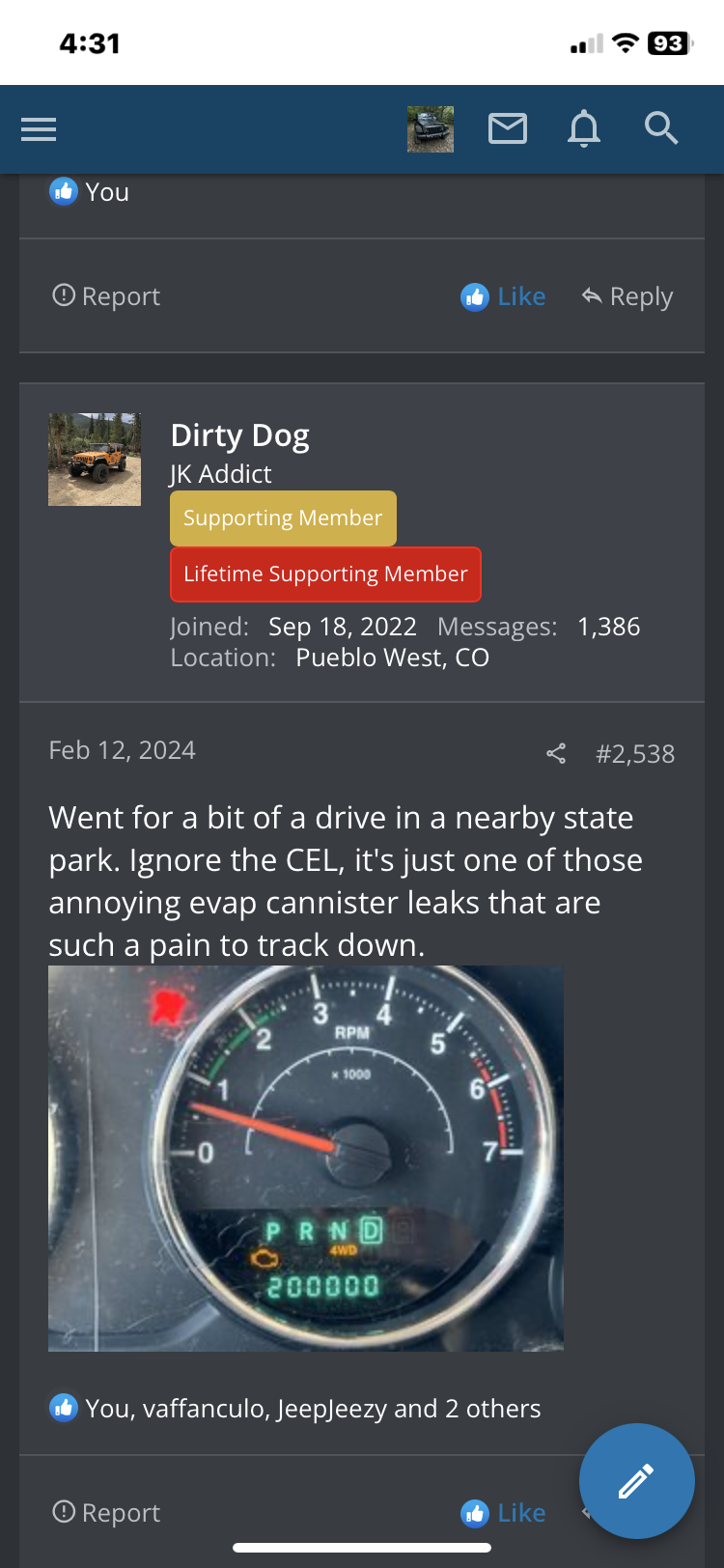

Yet lol that must be the check engine light u spoke of the other day that u hadn’t got time to fix yet. Must have over looked that one🍺🍺
