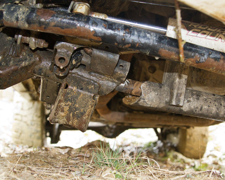

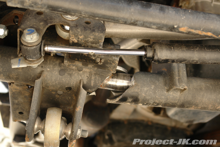

A decently built TJ30 will hold up near indefinitely on 35"s if maintained and setup properly. On a 2-door JK, they are practically indestructible as well. When you step into the 4-door JKU world, the JK30 holds up moderately well, though due to the inherent weight and width differences, they do experience more long-term fatigue failures. Issues like bent tubes and inner C's are much more common on JKUs (but are nearly non-existent on TJs), regardless of trail ratings. I've seen a number of bent JK30 housings in JKUs that have seen nothing more than dirt roads and pavement.
The issue of strength and longevity is exacerbated by increasing weight. If you plan on hitting 8+ rated trails with confidence and enjoyment, you'll likely be adding a considerable amount of weight in armor, skids, and more. Suddenly your ~4200 lb. Willys is now pushing 2.5 tons. Throw in a passenger, spare parts, extra fuel, a larger tire carrier, bumpers, winch, beadlocks, etc., and your Trail Burrito has now eclipsed 5500 lbs. in many cases.
It's at this point where breakages are common and frequent. It's also where they become spectacular and catastrophic...
It should be noted that the JK44 also suffers from weight-induced failures, since they essentially have the same housing strength:
Seeing stuff like this is not uncommon on the trails out west: https://jpfreek.com/2016/01/06/broken-axle-housing-lessons/. Nena (from Barlow Jeep Adventures in Sedona) used to have a bunch of photos on one of the local AZ Jeep Facebook pages of all the destroyed axle housings, but I can't find it now through a Google search.
