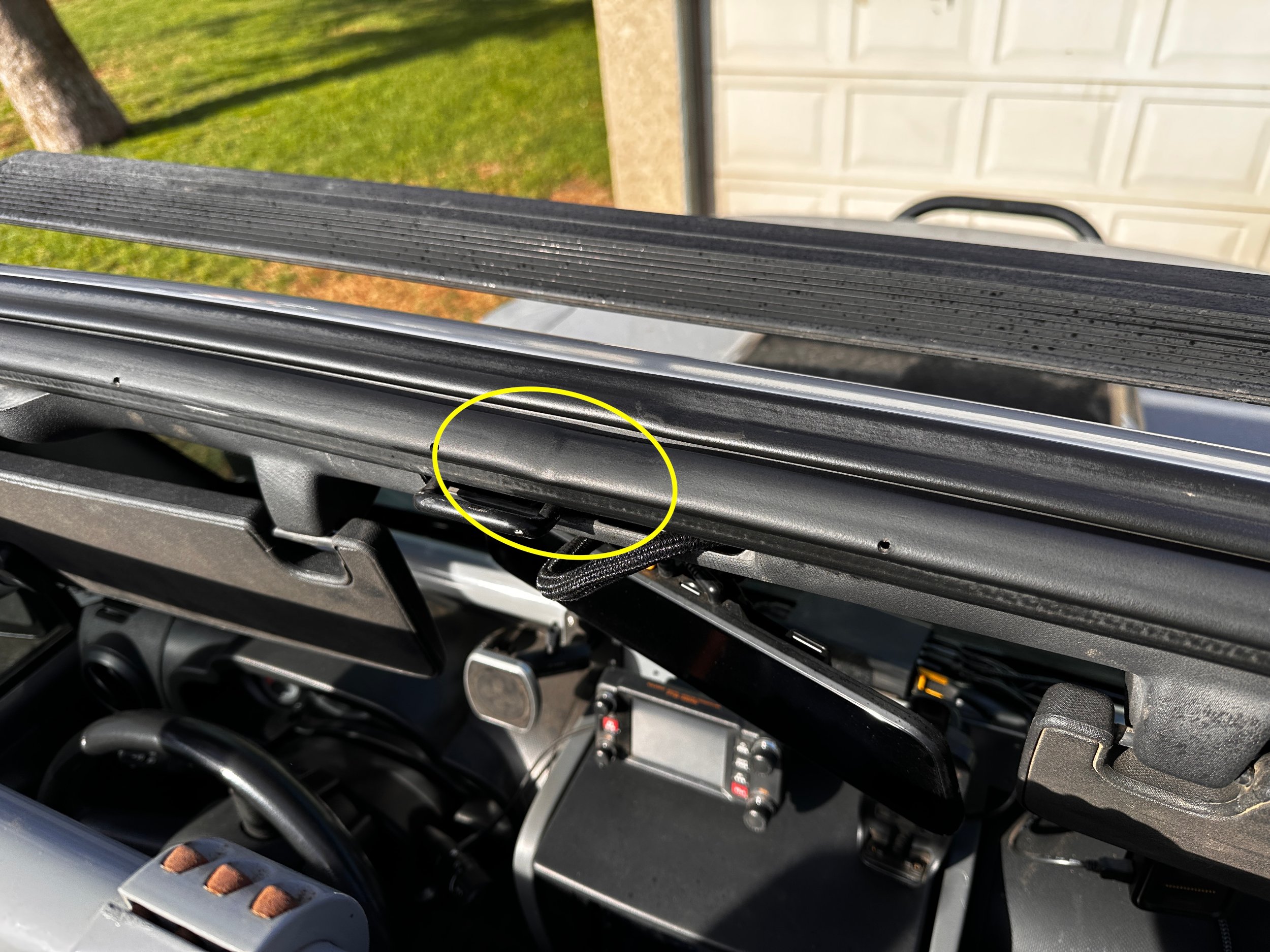

I have learned that my 2007 JKU came with a soft top and half doors. The hard top was added after 2010, or at least it has a 2010+ hard top and full doors on it now. The "freedom" tops are definitely 2010+ as the front latch has the later latch on the front middle section. I found that most of the latches on my freedom tops were loose, even the two under the visors. I bent them a little to have more pull, the middle latch has a mod were the footmans loop is moved over a few inches so the top latch can grab it and pull down against the seal.
I also cleaned the seals real good with soap and water then put on some rubber seal conditioner, they seemed supple and not real dirty. I think it just needed some tension.
Fingers crossed. We have some rain coming in the next hour or so for me to test the tweaks. blue arrow shows footman loop modified location.

Well the rain is here and so is the leak. 😖
The leak is possibly a little slower. It is dripping right at the pictured footmans loop, on the right post/leg. Now, it is possible the leak is traveling but that seems to be where the two tops meet as well. Frustrating. everything looks like it is supposed to.

The seals on the panels look fine, I did clean and condition the panel seal as well. There seems to be a seal "convergence" issue, meaning the leak is coming in at a junction. If you look at the pic with the blue arrow, right above the right arm of the footmans loop is a little indentation on the upper/header seal. It seems like the culprit is right there.
Sorry to hear. I think I would be trying to replicate the leak with a hose to understand if it's occuring close to the point you indicated (from the outside) or traveling from some area first.
