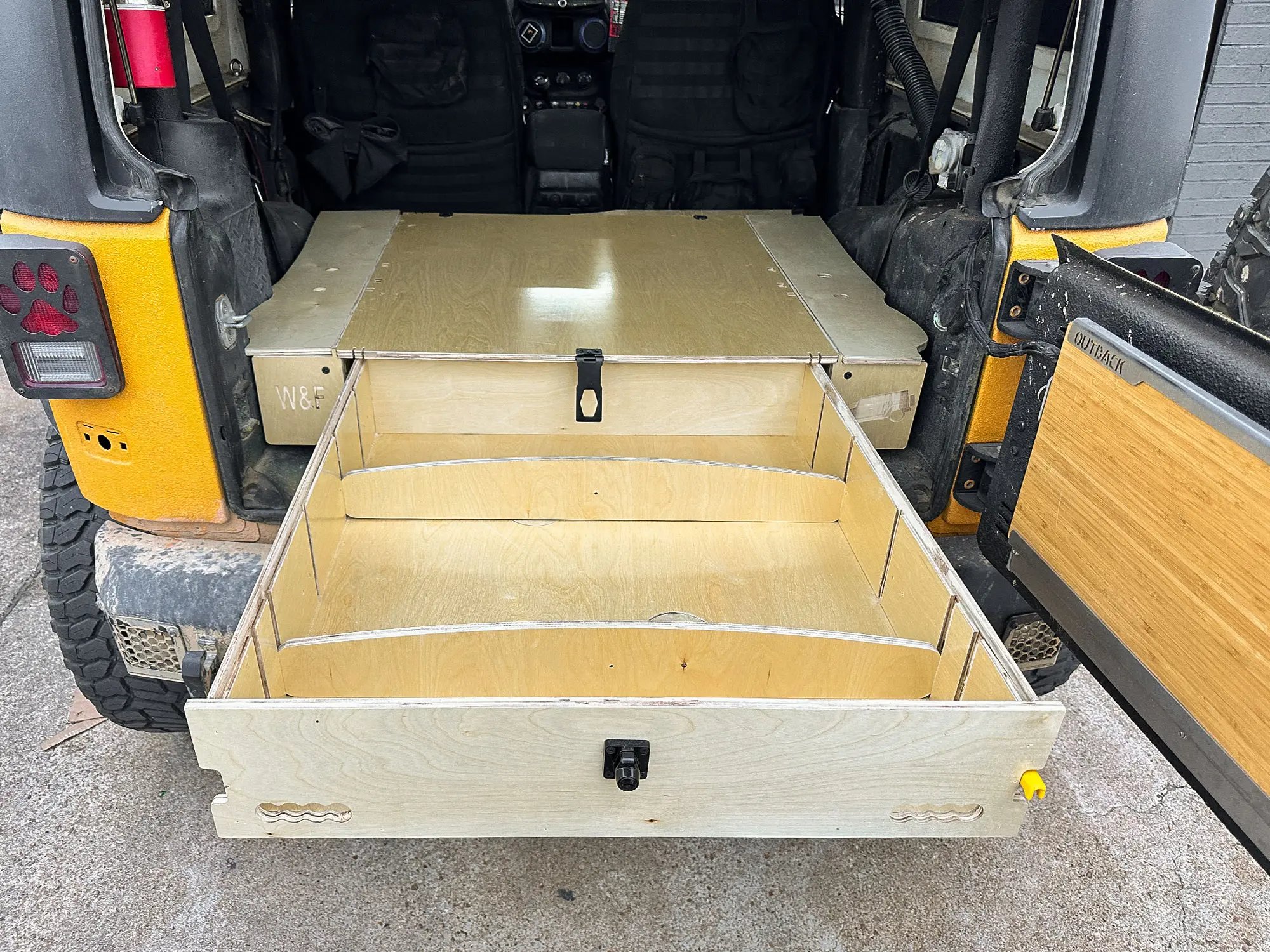

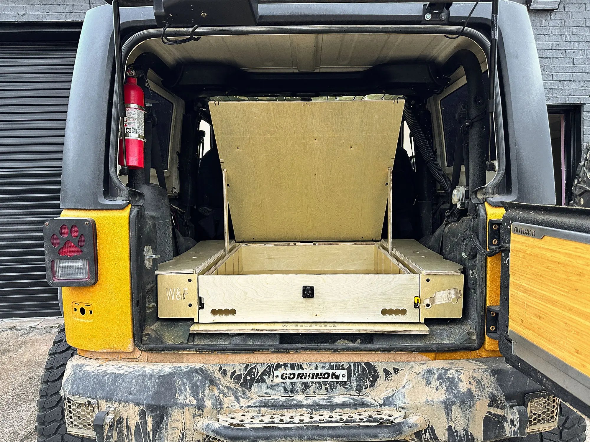

EDIT: I was going to remove my back seat too, but wanted some secure storage. Began making one like this (not mine), but it met an unfortunate accident. Starting over...
