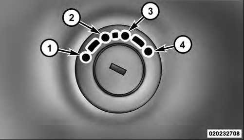

D DebbieA New Member Joined Feb 7, 2021 Messages 1 Location Florida May 17, 2021 #1 Which position on the ignition is off/unlocked for flat towing? Reactions: Danarch
JerryD ¯\_(ツ)_/¯ Supporting Member Joined Dec 20, 2019 Messages 902 Location West Michigan May 17, 2021 #2 The manual says to put it in to ACC. See the diagram below. 1 — LOCK 2 — ACC (ACCESSORY) 3 — ON/RUN 4 — START Reactions: mrjp
kk2010jk Member Joined Dec 2, 2020 Messages 86 Location Milford NJ May 18, 2021 #3 Flat towing my 2010 manual I do not use key. My JK does not have a locking steering wheel. All my electrical needs come from power I added from 'Always on' circuits from the fuse box. Actually I lock the doors while I tow.
