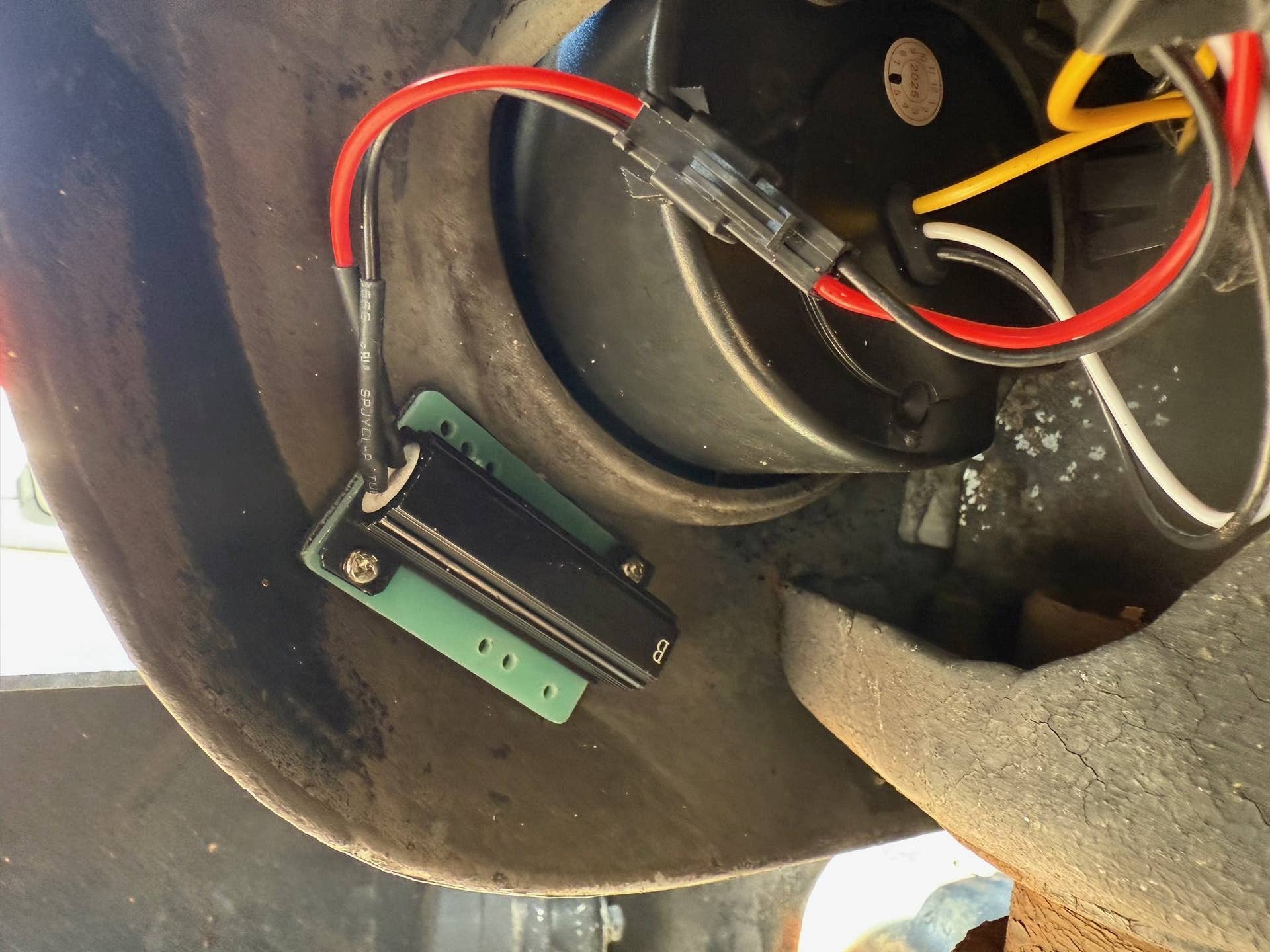

Everything works perfectly except that the turn signal flashes very quickly. The turn signals have a resistor, as shown in the photo.
How can I fix this? Is the resistor insufficient, or have I connected something incorrectly?

You have the resistor wired wrong. You have black going to red and red going to black. Reverse those wires and you should be good to go.

Thanks for your answer, I saw that to tonight after watching the photo close again :-)
But this is the only way the sockets will fit, or did i put the left on the right side and vica versa? I would think they are the same for both sides…
I will check tomorrow and let you know!

I doubt they are left and right sided. It's very possible the manufacturer messed this up. It happens more and more. You might be able to get a thin paperclip and pop the pins out of the connectors to swap the wires if you're not comfortable splicing the wires correctly.

I will cut the wires and connect them with new correctly connections (after testing it)
I also think it’s a factory mistake because both sides are in te wrong order i checked this night.
Will lett you know tomorow i also have backup resistors :-)
Okay, I swapped the wires on both sides, but this had no effect.
Then I used my backup resistors instead of the ones in the picture. This seemed to work for a short while, but after turning the turn signals on and off 6 or 7 times, the error still occurred (but this time only on one side of the car, not both sides, and then randomly).
