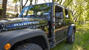

I have the Smittybuilt Defender rack and you can buy the brackets for your hi-lift. The pic below is of a different variant of the rack on another vehicle, but it mounts the same:

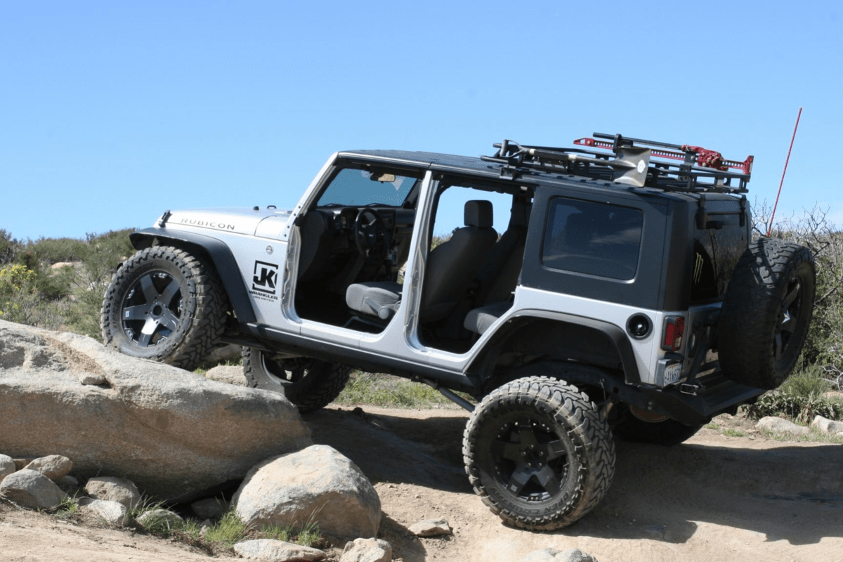

I have an aftermarket tire carrier & mount it there when I take it. If you have room, inside is great to keep the mechanicals from getting gunked up. My preference is not the hood - not so much because of the potential for visual obstruction but just because it's not the most convenient place to retrieve from. I also don't care for it on the top just because I'm one of those low center-of-gravity types. Having a roof rack or transporting stuff up there is great but I don't like doing it on the trails in a 2dr.
There are tons of options out there and everybody has their preference. There are even some that mount to the side that may be an option for you.

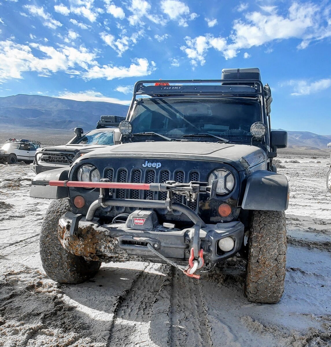

DO NOT. I repeat DO NOT mount on your hood. In the event of a accident, the mounts for a hood mounted hi lift jack can fail and it will turn into a deadly weapon. Maybe not for you, but someone else.

It's an inconvenience, but I like mine up top. I've been lucky enough not to need it, but it's either up there or mounted somewhere near the spare- the only choices I'd go with.
