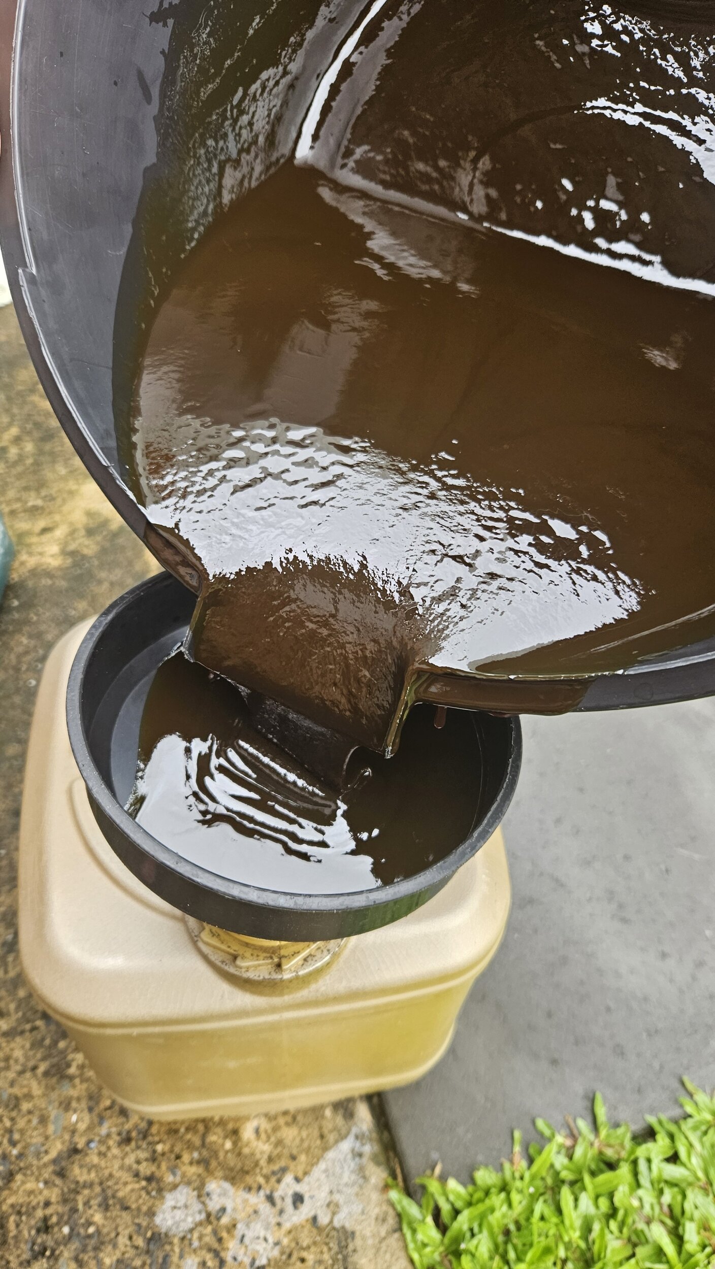

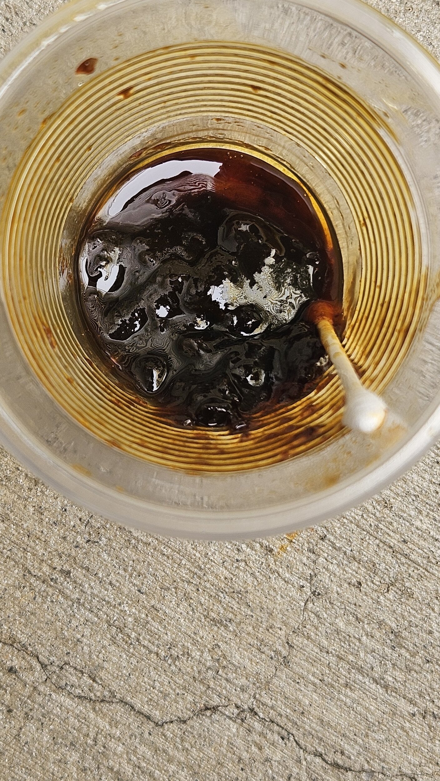

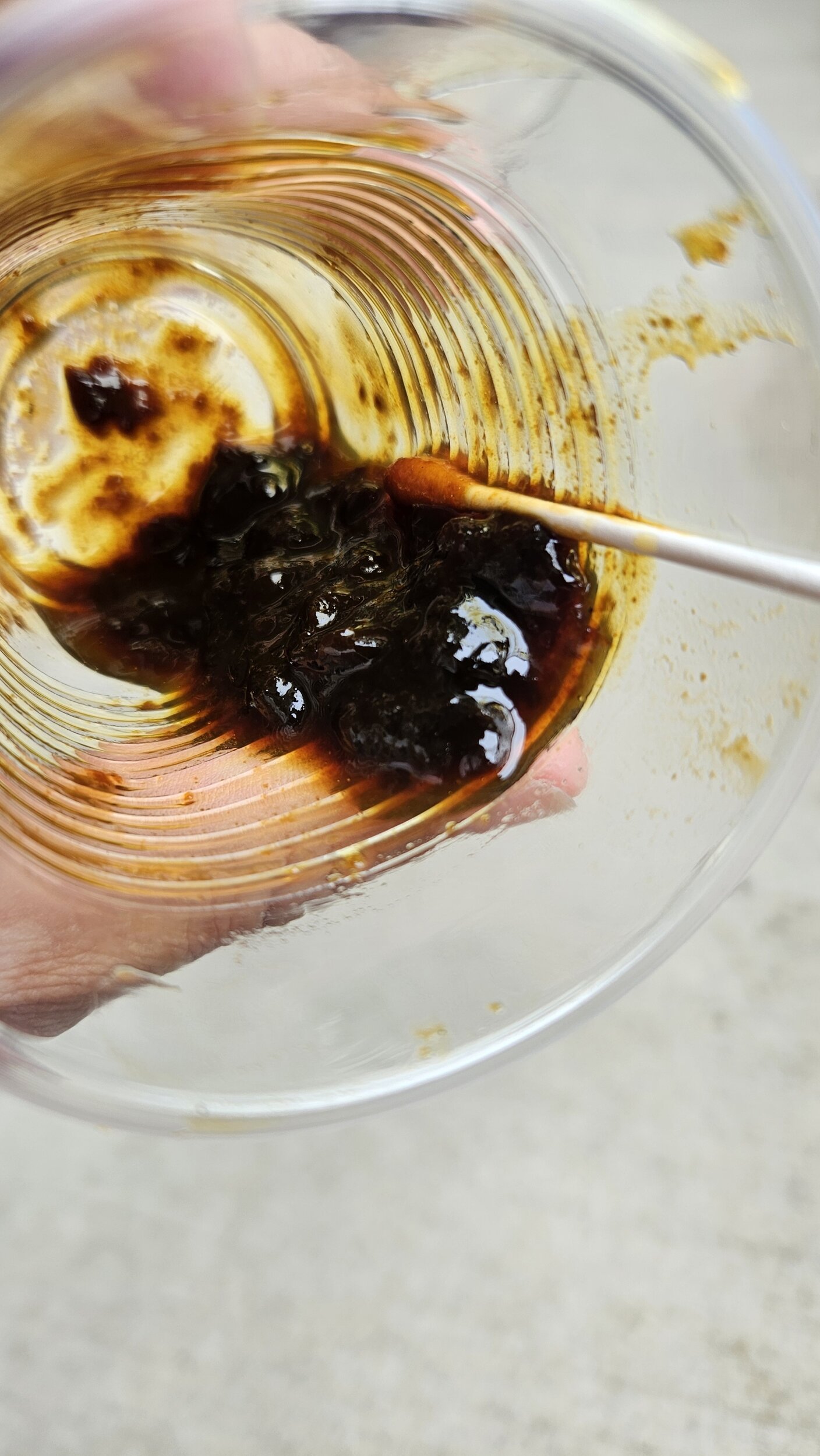

Looking to see if anyone has experienced this issue with the engine oil. Jeep Wrangler 2015 V6 3.6L Manual
Second owner, purchased from Jeep dealer who serviced it from new. After purchase replaced the engine oil and filter with Castrol Edge 5w-30 A3/B4 as per Jeep dealers advice. The jeep is not a daily driver and gets used short shop trips every couple of weeks and occasional longer trip about 300km. The oil has been in the car approx. 14month and the car has done 6,400km since change. I decided to change the oil again and this is how it came out. I have tested the pressure of the radiator and it appears ok there are no leaks. I have left the sump plug off for few weeks with a clear cup attached to see if any coolant comes out and it’s all good no coolant. There are no error codes. I have been changing oil in my car and have never seen anything like this. I have flushed the engine and about to use Penrite Enviro+ 5W-30 Engine Oil and run it for a week or so and see how it comes out. Thanks in advance
