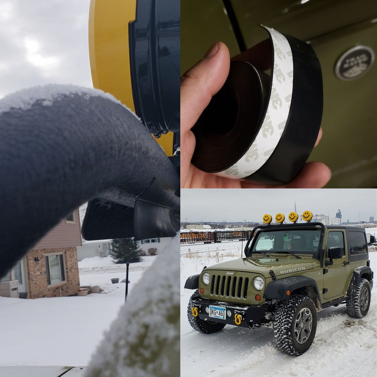

Just a heads up for anyone trying to eliminate that whistling noise from their windshield light setup or roof rack. I applied this adhesive silicone door seal along the length of my old school style JK light mount, and it works. I've seen other posts where people wedge a thicker door insulation or foam between the fins on the back of their LED bars, but this solution can work for the non-LED folks.
I used to hear wind whistling at any speed above 35, but now it's gone!
Reactions: Chris
One more thing to add, just be aware that Amazon is rampant with bootleg 3M products. Some of the stripping I bought came in generic packaging with chinese lettering, and the double sided tape doesn't hold to the rubber as good as the authentic 3m stuff I use at my day job. I'm going to replace the adhesive with VHB tape to ensure the rubber stays in place for a long time.
