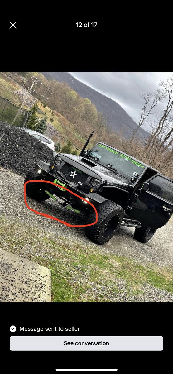

Does this look normal? Dual stablizer
<blockquote data-quote="Speartip" data-source="post: 454845" data-attributes="member: 23341"><p>The middle should def not droop like that .</p><p> Dual stabilizers are more for show . A properly front end set up only needs one stabilizer . </p><p> Would suggest to get Jeep inspected with a good focus on alignment and geometry on front end .</p><p> It’s possible current owner was chasing around wobble or vibration and put on a band aid “ dual stabilizer” hoping it would fix problem</p></blockquote><p></p>
