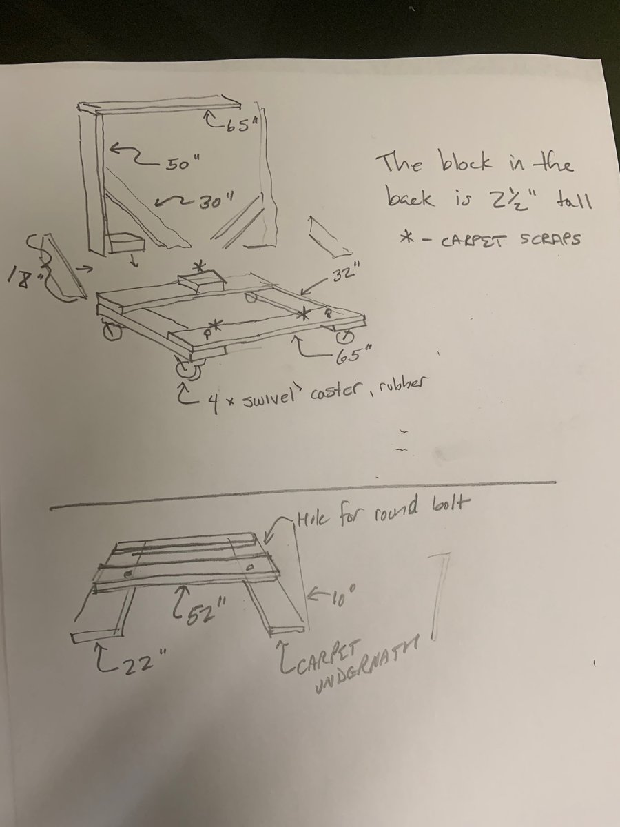

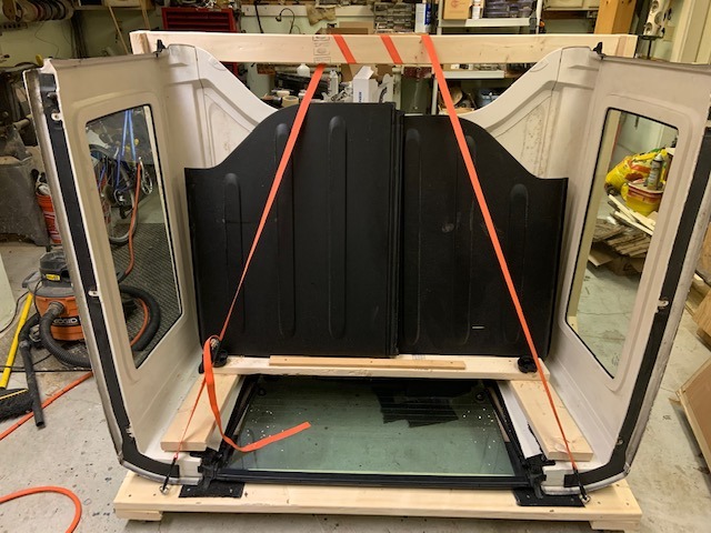

					I built this and posted in another thread, and was asked for plans.  Cost is about $60 or so, mostly the cost of the casters at $9 each.
					Nicely done, thanks for sharing this.
It certainly makes it a lot easier to move around the hardtop, that's for sure. Sometimes I wonder if I actually want mine hanging from the ceiling or not
