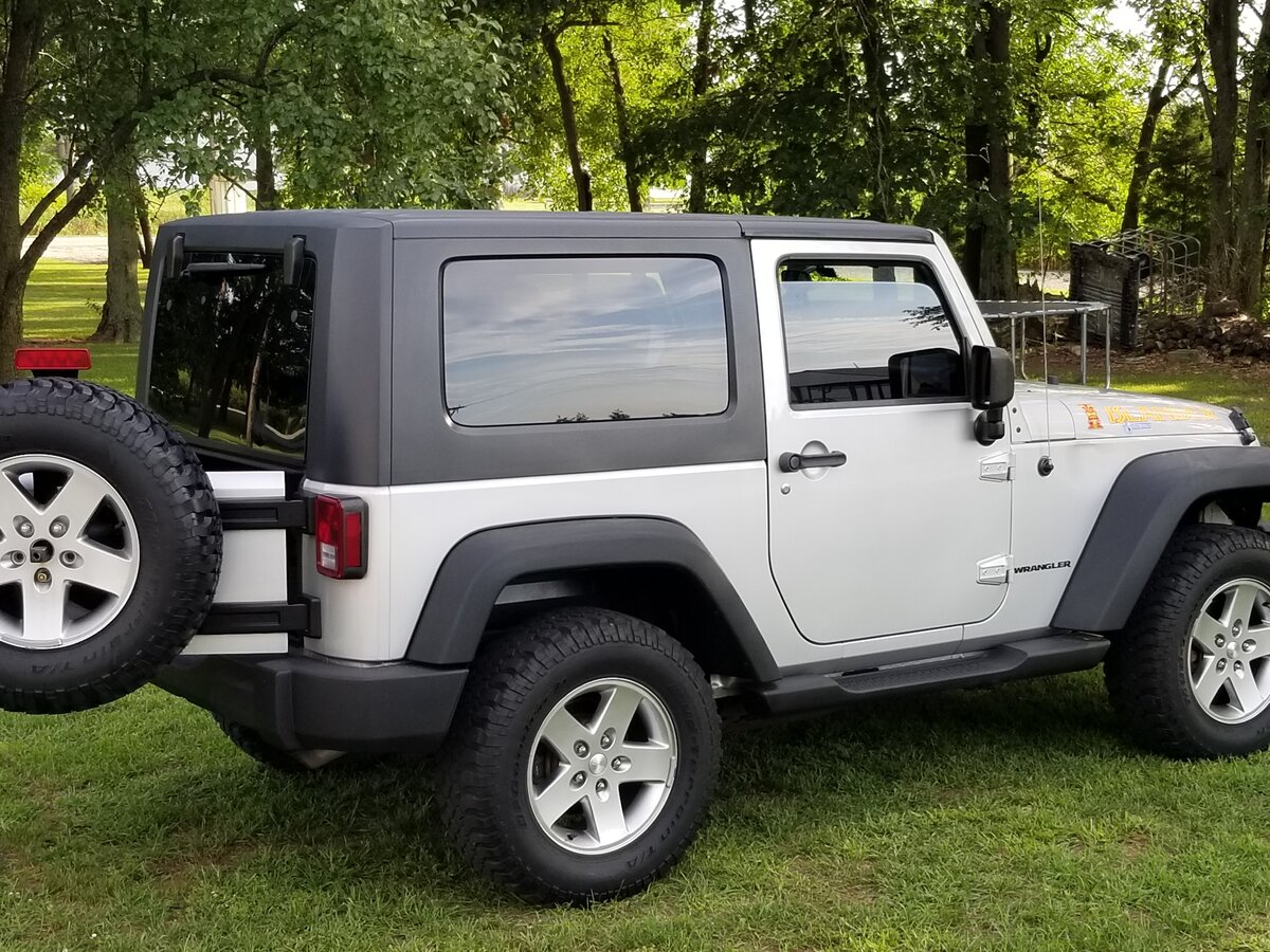

Just purchased a 2010 JK with 36,000 original miles and fully stock. Driving it home from purchase and got the death wobble after a small bump. Did it again a couple more times at 50mph. Every thing on front end seems tight. Only thing I can think is it still has original tires which are wore and severely dry cracked. Any one else have any info about this issue? Thanks in advance.
