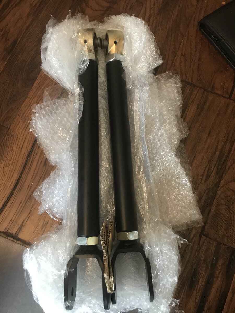

Pretty fired up! Core 4x4 Double Adjustable Front Upper Control Arms arrived!
Traded emails with Spencer and was willing to wait on production of these.
They’ll be on my sons JK this week.

Tier 4, I figure if I'm wrenching, might as well put it in big. I've got 35's on my son's 08 JK, want it to be ready to go heavy when we go out.
Out these on and started measuring Caster. Went from 3.2 to 6.0. HUGE difference in drive-ability. Return to zero is better, but ran a test run and my son had to run to work, woohoo, so he delivered pizzas in it and said it was money. I think I may take it to 6.7 or 7 degrees and try it, either way they are great,
By the way, the driver’s side came off no problem, but eh passenger side was a PITA. The exhaust was in the way and I couldn’t get the bolt out. Cut it, went and got a Grade 8 and washers at Lowe’s, and of course had to run a 1/2” drill bit, and needed a super long bit, and made a second trip to Lowe’s, ha, made it much longer than necessary.
Installed the bolt from the outside of the frame and Bam, all good.
