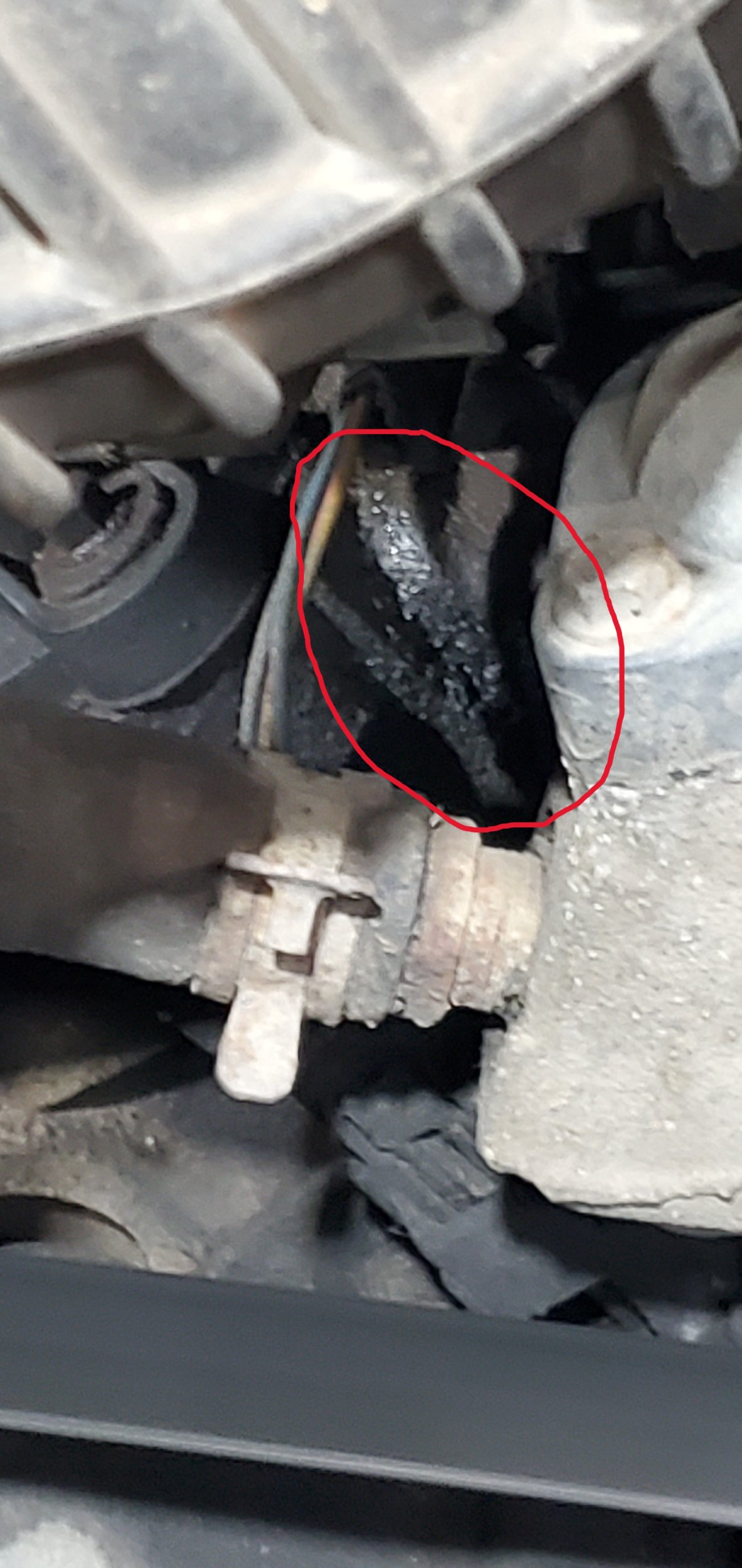

I have a 2010 Sahara with the 3.8L engine and 201k miles. It was starting to get warm (it did not overheat). I noticed the coolant was low so I added some. While I was there I changed the radiator cap as well as the stock cap had some deteriorated rubber. It seems to still be running a little warm (hovering around 230 degrees via the scan tool). I'll be the first to admit I don't know what temperature these are supposed to run.
Anyway I decided to see if I could find the leak. After a bit of searching I believe I found the leak. It appears to be pushing some coolant out between the intake and the head at the front of the passenger side. There is definitely stains on the front of the engine to support this. There is no coolant in the oil.

OK so I think I have a plan of action. I am 99.9% certain it is not a head gasket issue.
1. Drain collant
2. Change water pump
3. Replace lower intake gaskets
I'm reading the Chilton site on how to remove the upper and lower intakes. Are there any tips or tricks or things to watch out for? Thanks!
----Jer
OK so I think I have a plan of action. Since I am 99.9% certain it is not a head gasket, I am going to go ahead and change the water pump. While the water is out of I am going to go ahead and change the lower intake gasket(s) as well.
Is there any tips, tricks, or gotchas to removing the upper and lower intakes? Thanks!
