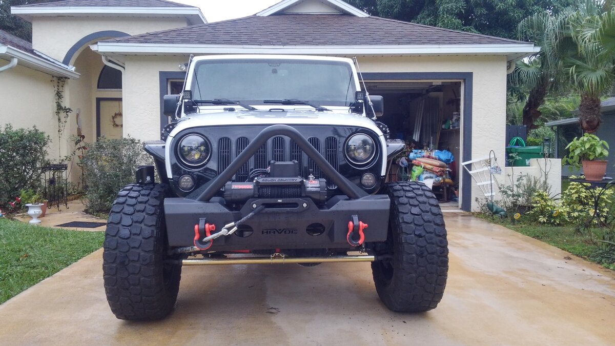

Hello all. Just bought a beautiful '16 Willy's Wheeler Wrangler that has had a TON of upgrades added. Only had the truck home for a couple of days and decided to change the oil and coolant. Everything was fine until I took the plastic coolant back up reservoir out to clean it and found a handful of what honestly looked and felt like peanut butter caked to the inside bottom. Washed right out with hot water though. No signs of blown head gasket (ie: no coolant in oil, no bubbles in radiator, no milkshake in the radiator etc). Car runs great, heater works, no white exhaust, plenty of power, etc. Any ideas?? Thanks in advance.
