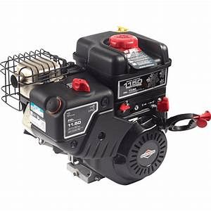

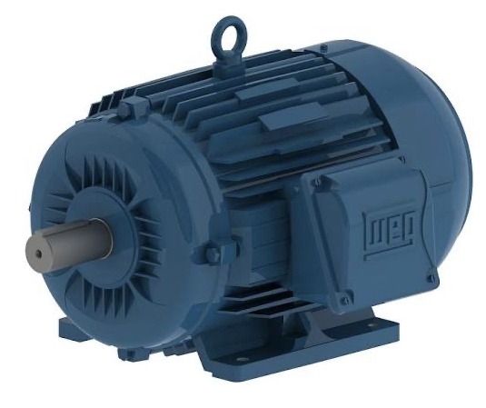

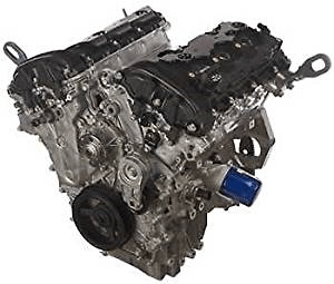

I do not know where the CAI of this motor, wonder where to hook up the snorkel. Need Jerry B. on this one I think.
See the 3/4" shaft with a 1/8" hole in the middle?Can anyone tell me where the fuel line hooks up ? I wanna run it on propane, so it doesn’t flood when I’m climbing steep grades.
