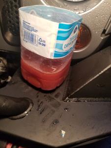

so today i bought a replacement thermostat and pulled the old one off. when i did so i caught the coolant that spilled out and this is where my real concerns start. the coolant is opaque. in my experience this is never a good thing. would this be a trans problem? i've heard of transmission lines blowing in other vehicles and ATF mixing with coolant creating a "milkshake" like this. to the best of my understanding this rig should be using OAT coolant, correct? would it get cloudy like this if someone mixed HOAT and OAT? I checked the transmission fluid, and from what i could get off the dipstick it didn't look too bad. at least not from what i could tell.
does anyone have any insight for me? i plan to drain and replace all the coolant tomorrow, and then monitor and see if it gets cloudy again. does this sound reasonable?
see attached picture for what the coolant looked like..
