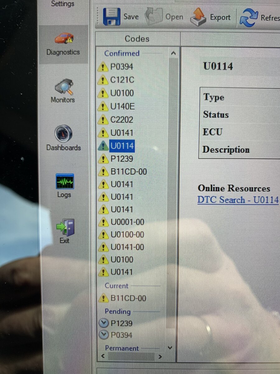

Same here. Replaced: both CPS, spark plugs, coils, rockers and lifters on passenger side and the exhaust camshaft. It only happens on the highway and if I give it a little too much pedal. If I carefully press the pedal to increase speed it doesn’t do it. But I can make it happen if I press the pedal more aggressively. Also she’s throwing other codes like: lost communication with FCM/TIPM, left hvac door moved to far (weird huh). My next investigation is to pull the TIPM and look for issues there. Anyone else having this issues?
Here’s a screenshot of the codes.
