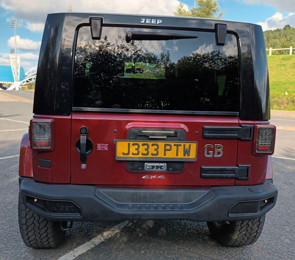

<blockquote data-quote="macleanflood" data-source="post: 460741" data-attributes="member: 23653"><p>I bought a spare tire delete plate on Amazon. I also bought stainless head studs for a early 2000s Ford modular V-8 - 5.4 and 4.6 - M8 and 1.25 might be 1.5.</p><p></p><p>Studs let me hang the plate with RTV to delete the broken air vent.</p><p></p><p>Studs would let you easily pull the spare and the carrier if you so choose.</p><p></p><p>Be careful because removing the spare carrier removes your third brake light.</p><p></p><p>I'm all for an aftermarket stereo...they make ones with 10" screens that replace part of the dash...with a camera hung right over the hitch.</p><p></p><p>-Mac</p></blockquote><p></p>
