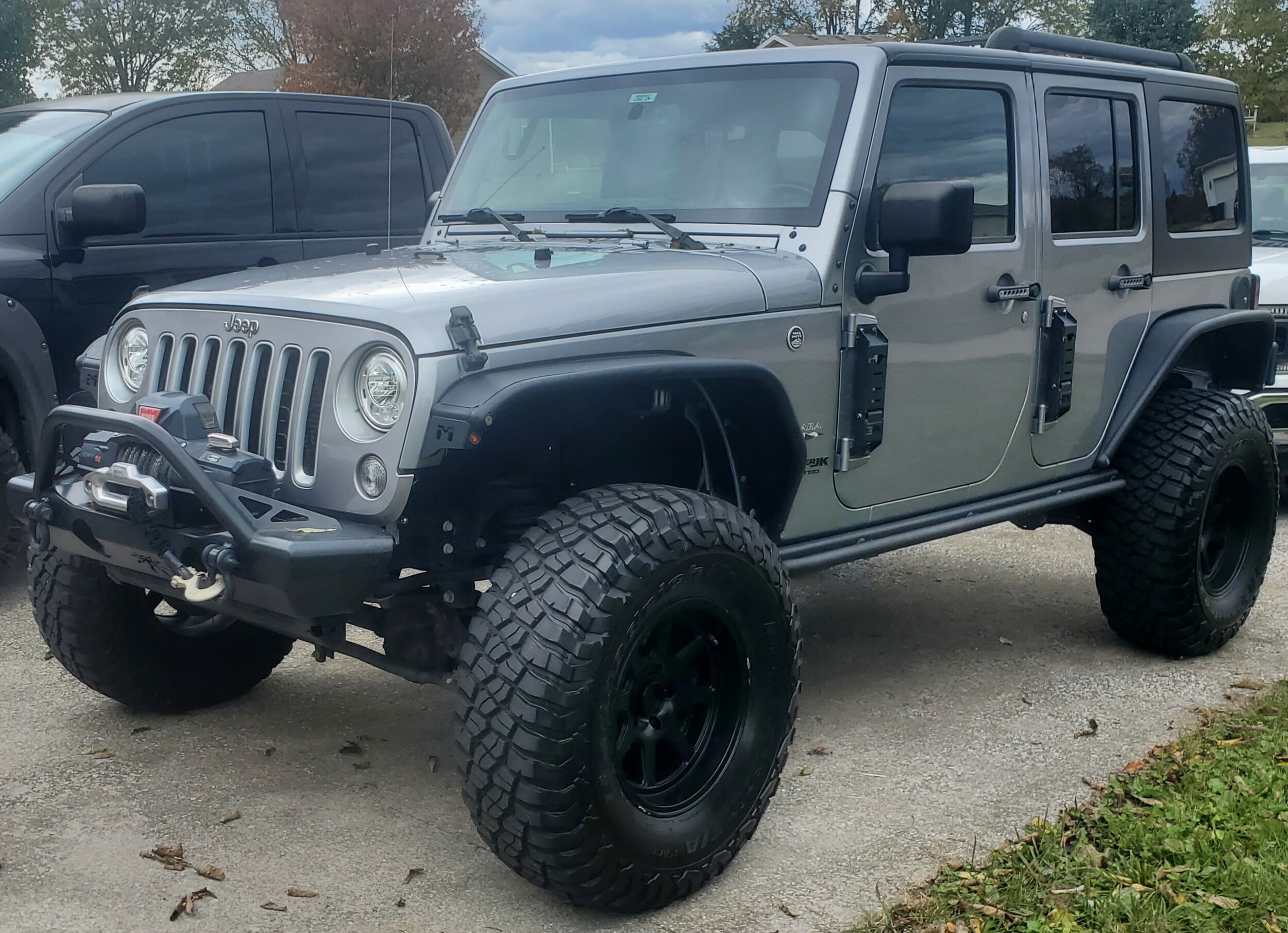

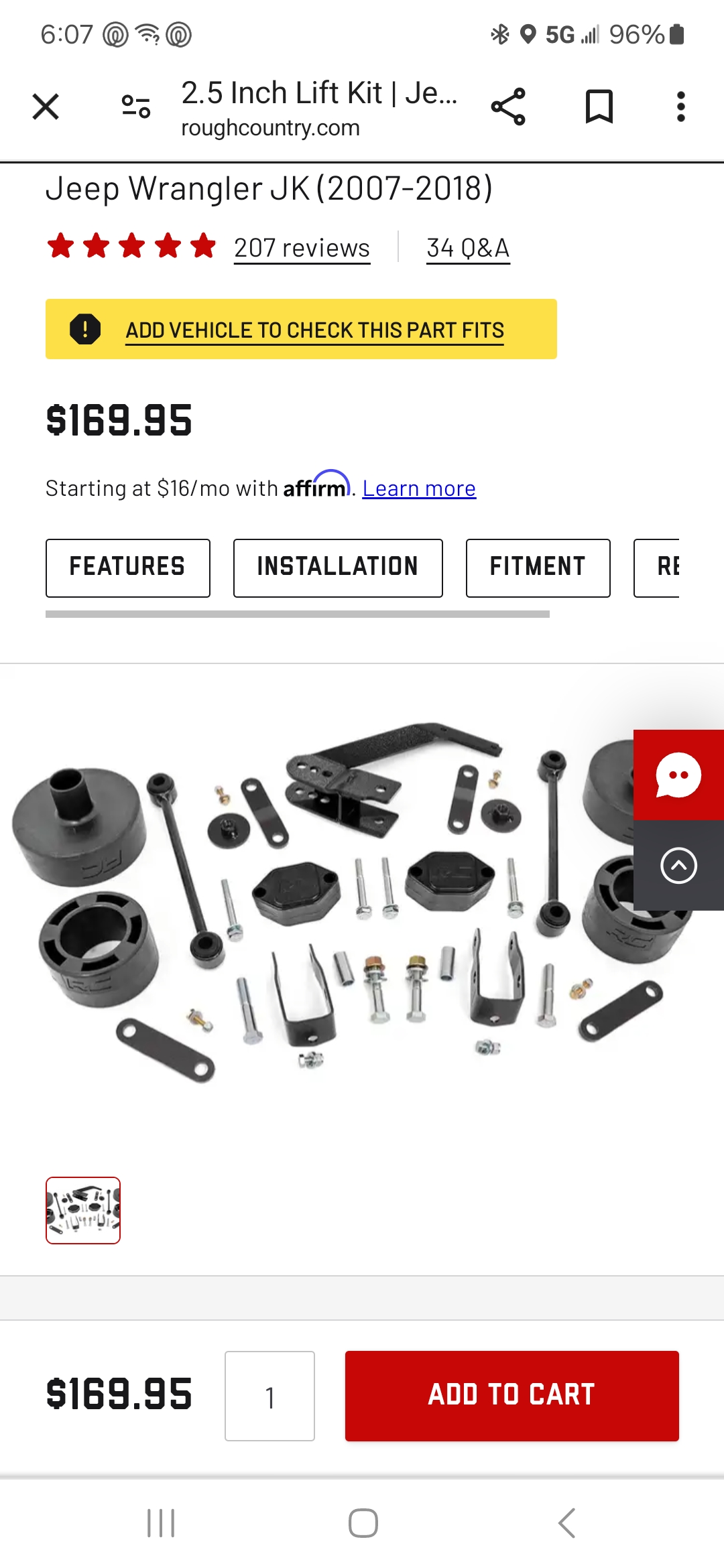

I have a 2018 jeep jku with a 4.5 inch rock krawler long arm lift . Can I add the 2.5 inch rough country lift to get some add heighth
Did that on a tj. Was a 2 inch spacer lift with a 2.5 inch spring lift. Needed longer shocks than the lift came with. Also there are some things that the smaller lifts do not come with that the bigger lifts do, like cam bolts (for axle alignment) and track bar relocation brackets, so keep that in mind.
Yes it is a coil spacer lift. I already have the 4.5 inch rock krawler long travel lift with shocks. Anything I should look for to be sure all works and fits
Watch for coil bind up. Not a big fan of spring spacer lifts. Originally thought you were going with a body lift.
Neither lift is designed to work together.
