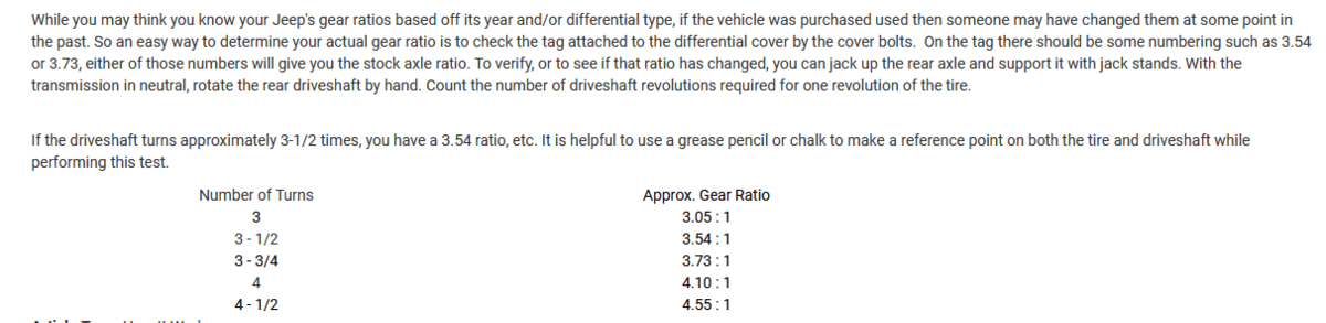

You don't need to pull the covers, I checked the ratio by jacking up the wheels, putting it in neutral and rotating the back tire. (the other rear tire needs to be held still) when doing that count the rotations of the drive shaft. that is your gear ratio. You can then do the same for the front.
As stated above, it is super important that front and back are the same.
The vid here shows how, though he doesn't mention that you need to hold the opposite tire in place. Or I guess you could just rotate the one tire twice.

On the edge of the ring gear is a part number, date, and teeth count stamped there. For example if it has 4.10 gears it would have 41-10, 41 teeth on ring gear and 10 teeth on the pinion.

This is a chart I've shared in the past:
