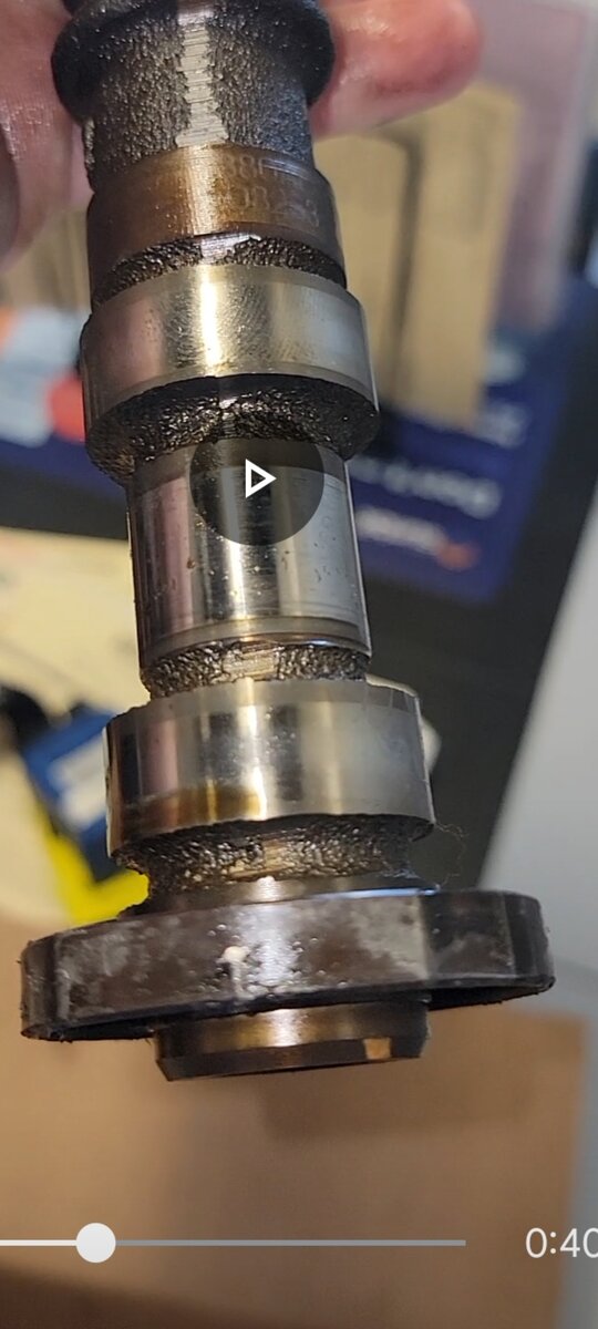

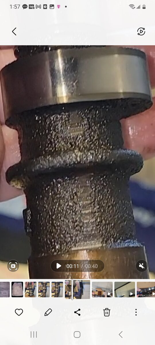

Hey guys,
I recently had to take my Wrangler in to be checked because of ticking noises in the engine while it runs. I was told it was the cam shaft that has been broken causing the noise. My wrangler is a 2016 Sahara. Does anyone know if this is a common issue and what to do to fix. I was told it could cost $4500 if not covered. Thanks for the help guys.

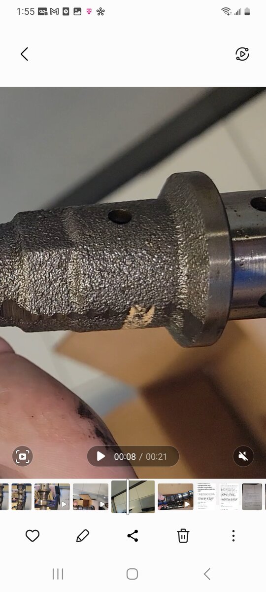

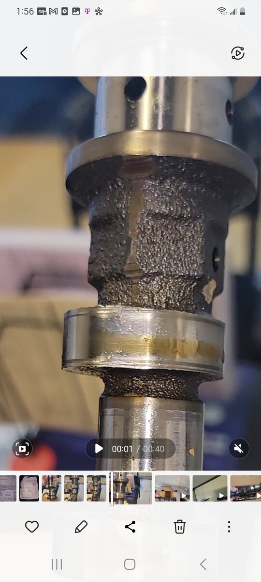

Agree with the above. If a camshaft is broken, certain valves wont open. It would run incredibly rough if it runs at all. I would ask another mechanic to look.
I have to agree. A broken cam shaft should be causing way more than a "tick."

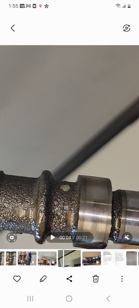

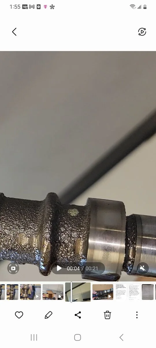

Same issue cam shaft wear 3.6 pentastar on 2015 jku. Took it in and dealer replaced all cams lifters rocker arms and rear main seal. My worry is the metal that was worn off the cams. anybody help is much appreciated
