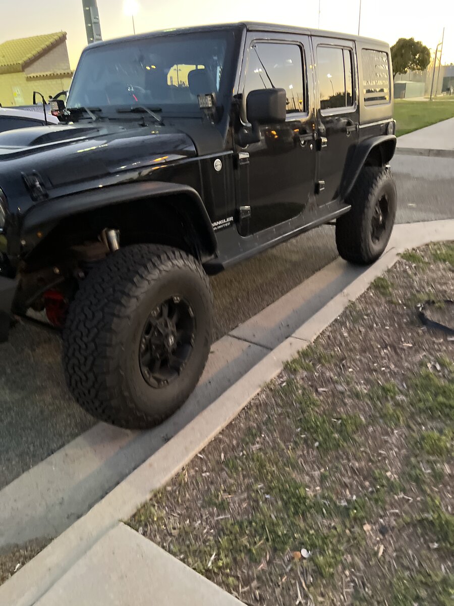

Hi Everyone,
I have a 2014 JKU with a 3.5” AEV dual sport lift and 37’s. I recently noticed that my bump stops in the front (OEM) are starting to fall apart. My question: should I replace with OEMs or opt for rubber, polyurethane or Hydraulic bump stops? I don’t know if the lift has limiting factors on what would work best. Also, if I replace the fronts, should I do the rears at the same time with the same type? Please advise based on your experience.
