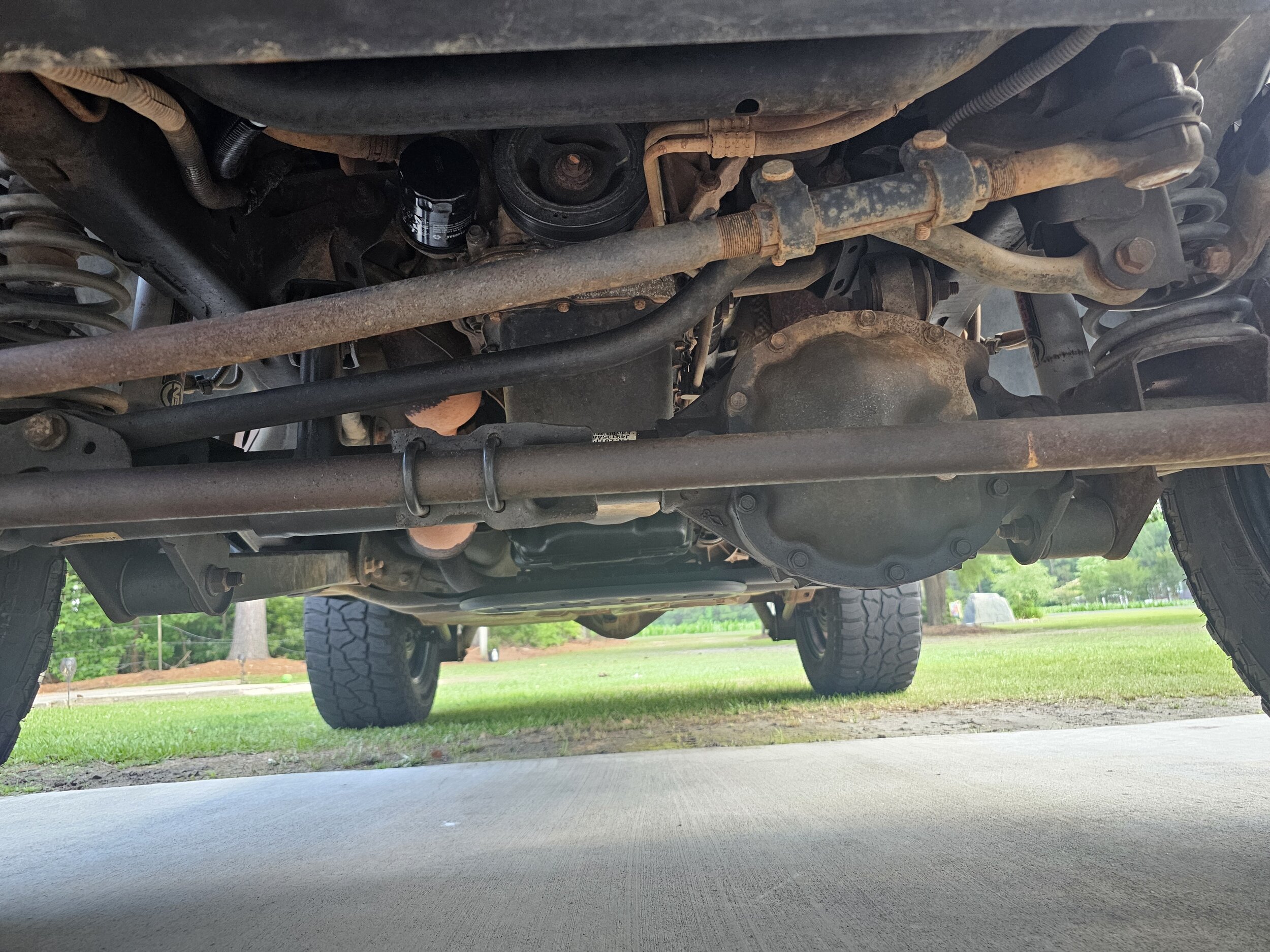

D dewfamily New Member Joined May 28, 2024 Messages 3 Location North Carolina May 28, 2024 #1 I just bought a 08 jk. After some digging it appears that it has bump steer. I took a picture of the front but it doesn't seem to have the typical unparallel. Any suggestions?
BLACKJKU Moderator Staff Member Lifetime Supporting Member Joined Feb 22, 2020 Messages 5,123 Location Huntington In May 28, 2024 #2 Stock tires, stock lift?
D dewfamily New Member Joined May 28, 2024 Messages 3 Location North Carolina May 28, 2024 #3 It has a lift , not sure how much. Tires are 305/60/18
BLACKJKU Moderator Staff Member Lifetime Supporting Member Joined Feb 22, 2020 Messages 5,123 Location Huntington In May 28, 2024 #4 dewfamily said: It has a lift , not sure how much. Tires are 305/60/18 Click to expand... Well I hate to say this but you probably have quite a bit going against you because most people just do tires and a lift and don't do them correct. Over inflated tires will do that, most will do the chalk test to determine how much pressure. Any lift over 2.5" should have adjustable control arms and adjustable track bars front and rear to make sure the axles are centered under the Jeep. Have you checked to see if the speedometer was recalibrated after the tires were put on? Reactions: tJKrider
D dewfamily New Member Joined May 28, 2024 Messages 3 Location North Carolina May 28, 2024 #5 Speedometer is correct
