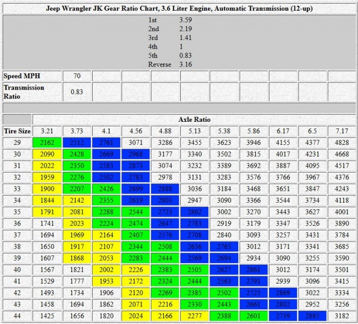

2012 JKU Sahara. It has the Hd tow package so I think I have 3.73 gears. Ultimate plan is to go to 37” or maybe 40” tires. Currently running 33”.
To get there I have a lot of upgrades so it will be staged. First will be to lift. Looking at Metalcloak 4.0 game changer. 33” will look too small (so will 35) but that will allow me to keep the stock flairs until I go bigger on the tires.
Then I will upgrade the axles to accommodate larger tires (Dana 60 seems the way to go).
Then get the tires and wheel flairs.
Does this sound like a reasonable order or? Should I just wait until I can do it all at once?
