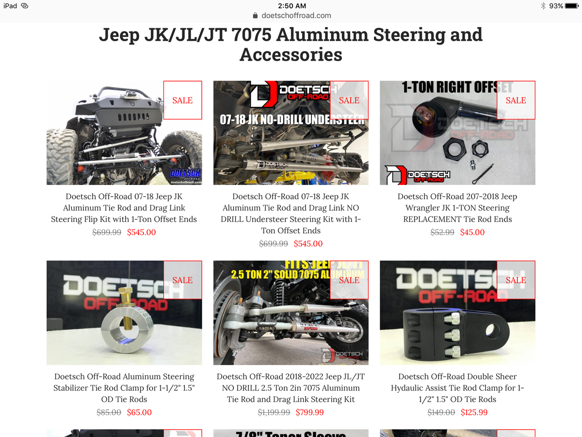

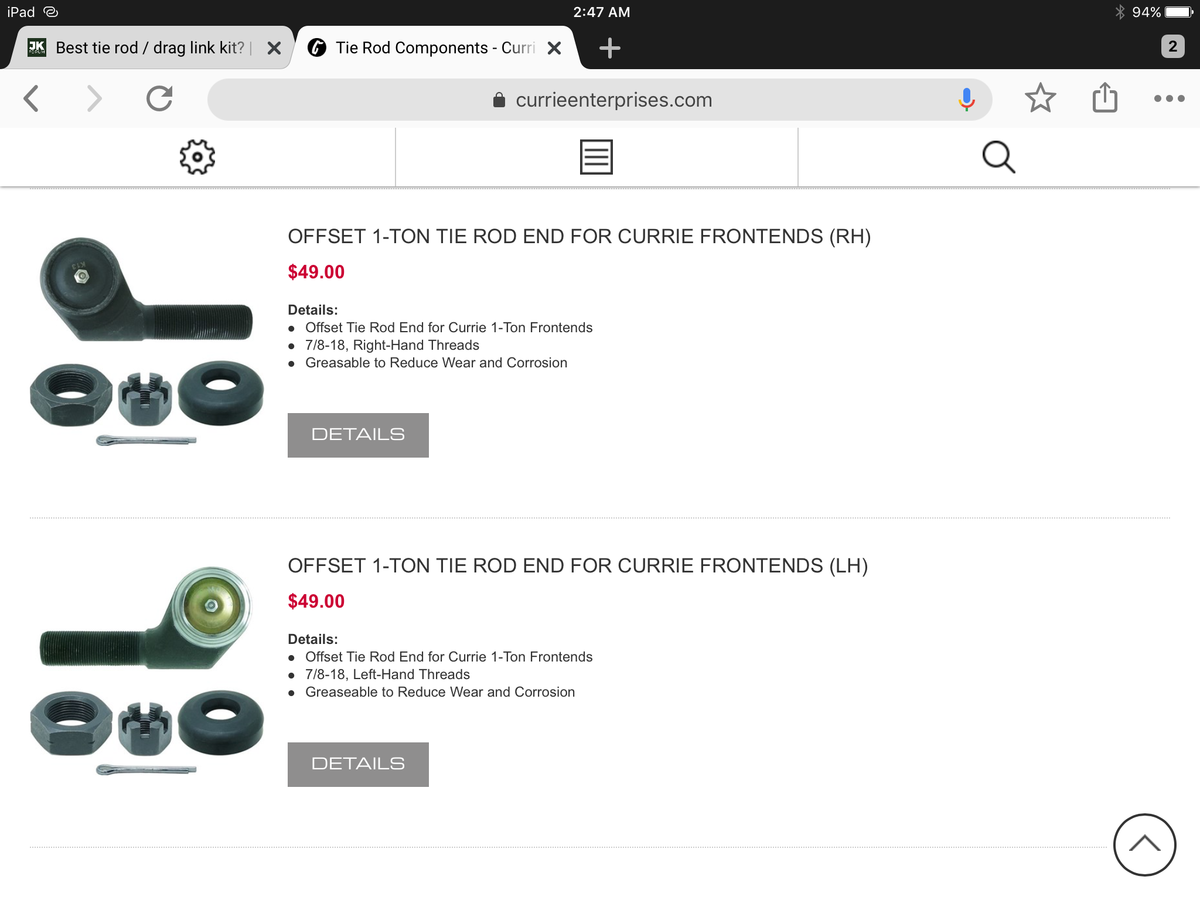

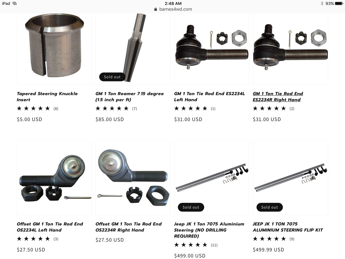

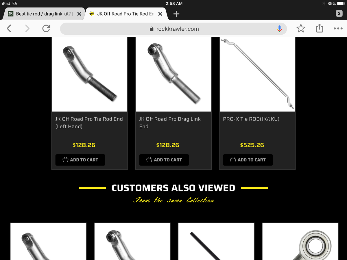

<blockquote data-quote="Speartip" data-source="post: 455372" data-attributes="member: 23341"><p>When you say Rockcrawl im assuming you mean Rockcrawler.</p><p> Reputable, Quality tie rods and drag links have replaceable</p><p>ends. 100 percent .</p><p>Barnes</p><p>Doetsch</p><p>Currie</p><p>Rockcrawler</p><p> To just name 4 have replaceable ends.</p><p>As long as threads aren't damaged in anyway toatally</p><p>safe to just replace the ends. Sounds like someone's</p><p>giving you inaccurate info.</p><p>Here are current ads from above manufacture's</p><p>showing ends available with pricing etc.</p><p> Keep in mînd these are 1 ton replacement ends.</p><p>Don't know what you have now . One ton ends are</p><p>bit larger than stock so will need wheels with 4.5"</p><p>backspacing .</p><p> If your current tie rods are 1 tons than you should be good</p><p>to replace just the ends.</p><p> If unsure which ones to get just send Rockcrawler or Currie, </p><p>depending what you have , an email</p><p>with a pic of your current ends and they could advise on</p><p>replacement . Hope this helps . Let us know how it turns out .</p><p>[ATTACH=full]123623[/ATTACH][ATTACH=full]123624[/ATTACH][ATTACH=full]123625[/ATTACH][ATTACH=full]123626[/ATTACH]</p></blockquote><p></p>
[QUOTE="Speartip, post: 455372, member: 23341"] When you say Rockcrawl im assuming you mean Rockcrawler. Reputable, Quality tie rods and drag links have replaceable ends. 100 percent . Barnes Doetsch Currie Rockcrawler To just name 4 have replaceable ends. As long as threads aren't damaged in anyway toatally safe to just replace the ends. Sounds like someone's giving you inaccurate info. Here are current ads from above manufacture's showing ends available with pricing etc. Keep in mînd these are 1 ton replacement ends. Don't know what you have now . One ton ends are bit larger than stock so will need wheels with 4.5" backspacing . If your current tie rods are 1 tons than you should be good to replace just the ends. If unsure which ones to get just send Rockcrawler or Currie, depending what you have , an email with a pic of your current ends and they could advise on replacement . Hope this helps . Let us know how it turns out . [ATTACH type="full" alt="IMG_2312.PNG"]123623[/ATTACH][ATTACH type="full" alt="IMG_2313.PNG"]123624[/ATTACH][ATTACH type="full" alt="IMG_2314.PNG"]123625[/ATTACH][ATTACH type="full" alt="IMG_2315.PNG"]123626[/ATTACH] [/QUOTE]
