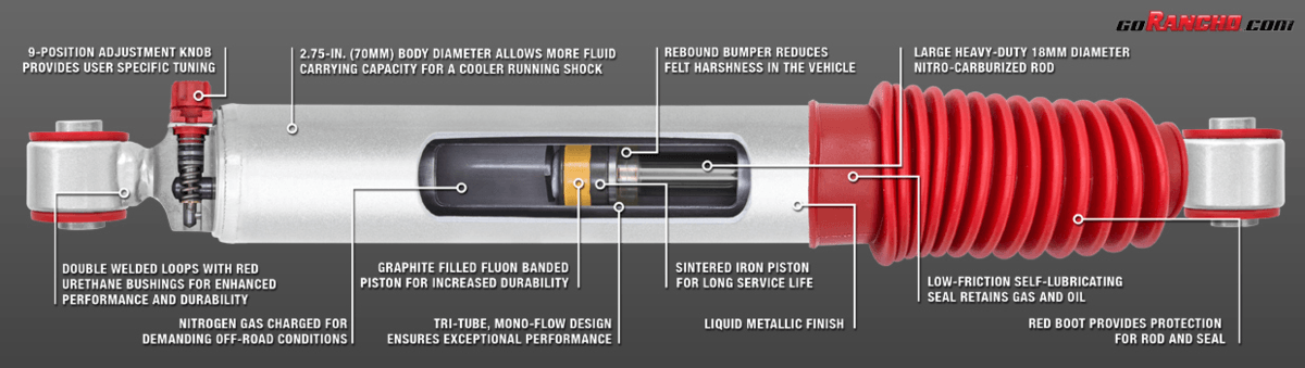

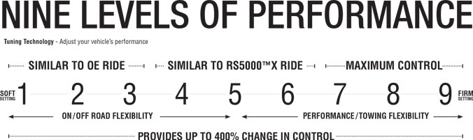

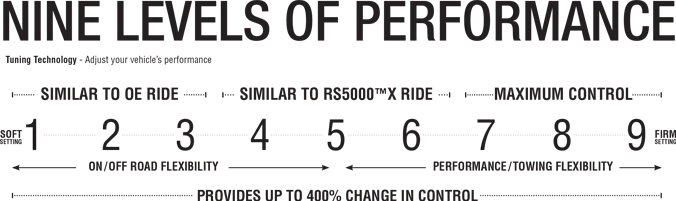

Like Mikester said if you want the top of the line go for the RS9000 XL - you can adjust it to where ever you want to go!
The best riding shocks I've ever ran (aside from custom tuned Fox shocks) are the Rancho RS5000X shocks. I've run off the shelf Bilstein 5100s, Fox, and OME shocks, and the Rancho RS5000X is by far the smoothest ride of the bunch.

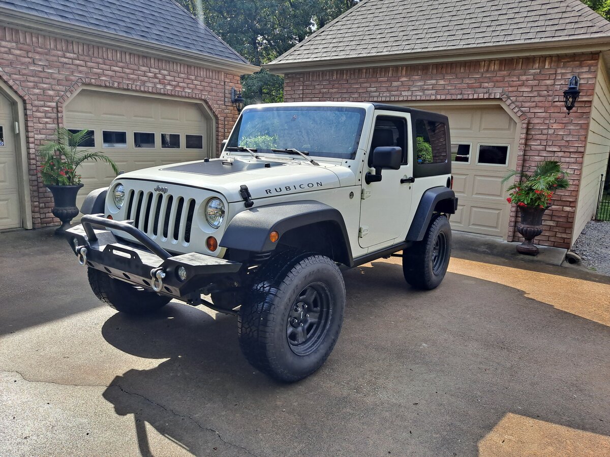

Well you guys, I was looking for some to put on my 2010 JK Rubicon... Had used Rancho before but couldn't remember if I liked them as well as Skyjacker...think you answered my question...Rancho RS5000X.
