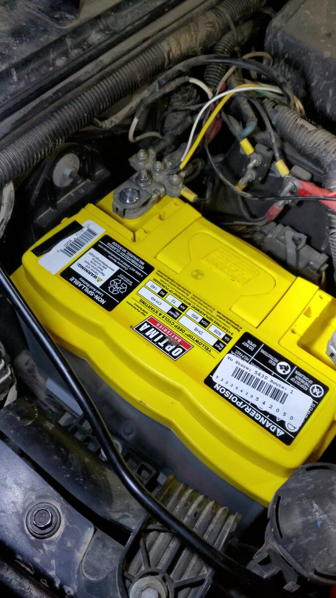

yeah doesn't want to go over 11.5V using the charger... i went ahead and ordered an Optima yellow top H6 one... hopefully that'll last.
Alright, battery was indeed the issue.
12.35v steady 😍
