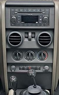

One of the auxiliary battery power ports in the center dash section is a key on hot and one is battery hot so splice into the key on ones wire.
That's the same style I use on my Ford, the trigger wire has to be a key on wire or it will cause your issue. If you have it connected at the battery cable at the starter then it's always hot.
I am going to sound dumb, but could you explain that a little better? Where would I find the auxiliary battery power port?
It's like a cigarette lighter port where you can plug in things that need battery power. They are usually depending on the years close to the HVAC controls in the center of the dash.
