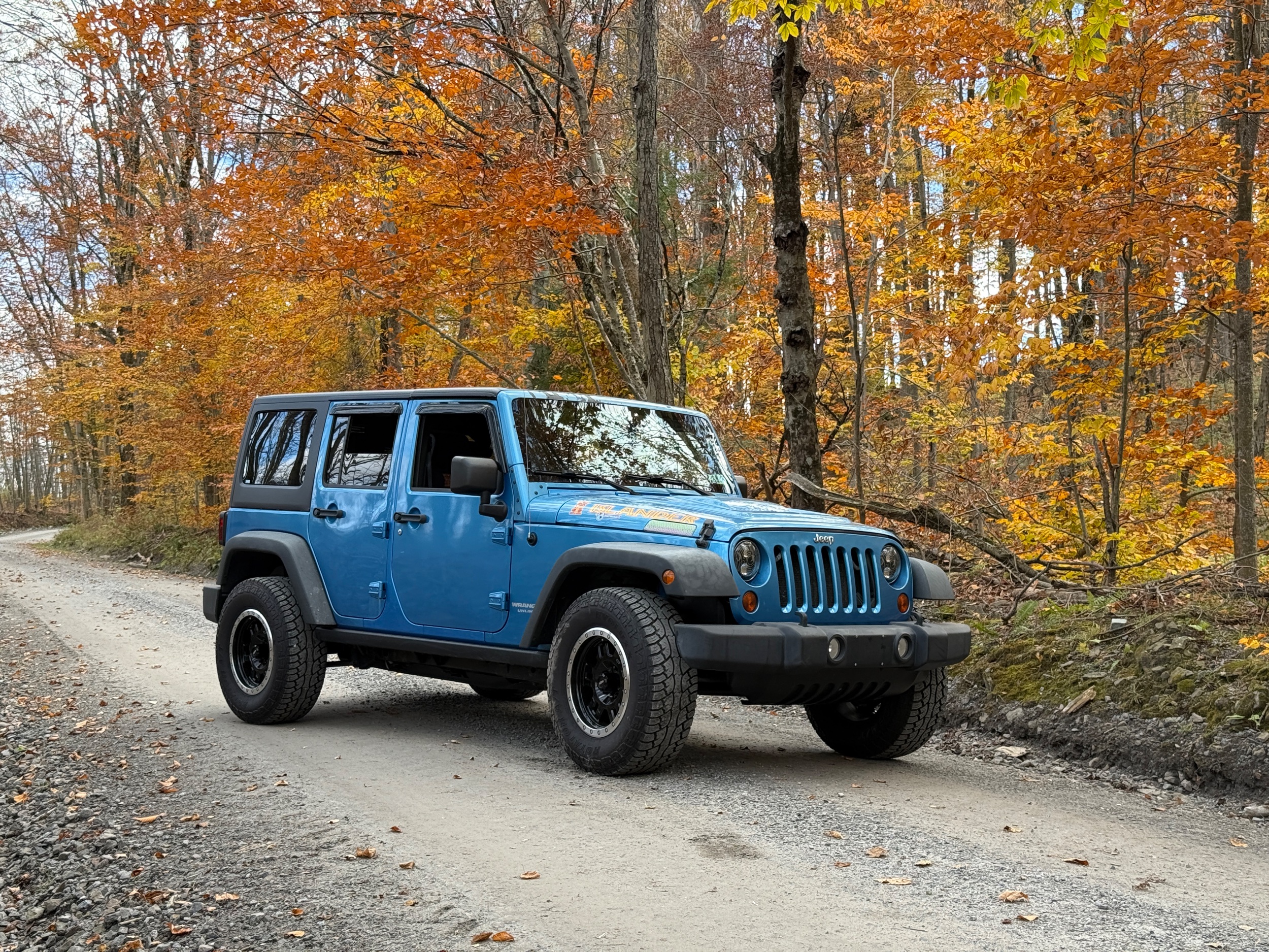

I’m running 285/75’s on my daughter’s Islander and it will rub ever so slightly with her factory Islander/Rubi springs and aftermarket wheels with 4.75” BS. Obviously it rubs a little more when flexed out but still manageable.
I suspect you’re still going to need spacers no matter what, as mine rubbed the exact same amount when I had these on my ‘08 JKU with 2.5” MC Gamechanger lift. Granted, I’m not familiar with the 75th anniversary edition wheels but they look like typical JK offerings of that era and if Google Search is to be believed, appear to have 5.5” backspacing.

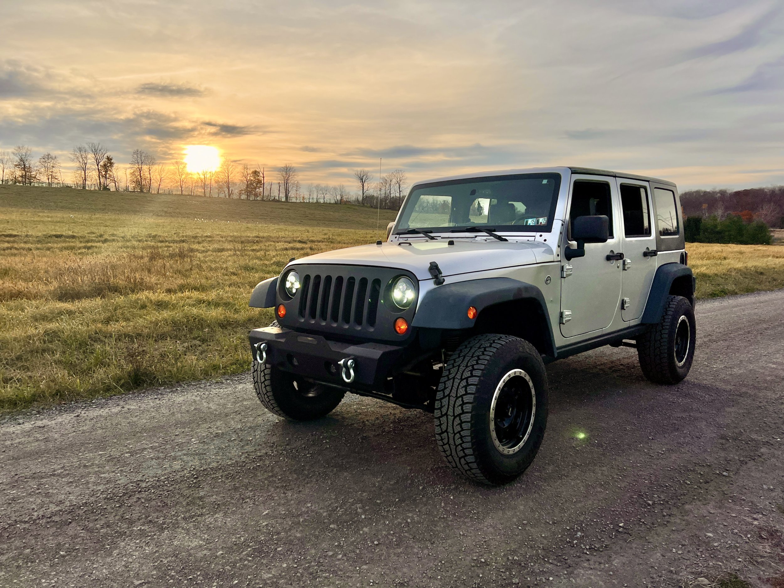

Your comments are super helpful m especially to add real experience for the setup I’m considering.
It’s a 2017 JKU and there’s nothing particularly special about the wheels except they are color matched to the bumpers that look like Rubicon 10 year anniversary bumpers.
So it seems like I’ll be in a rubbing situation even with the 285s and a modest lift.

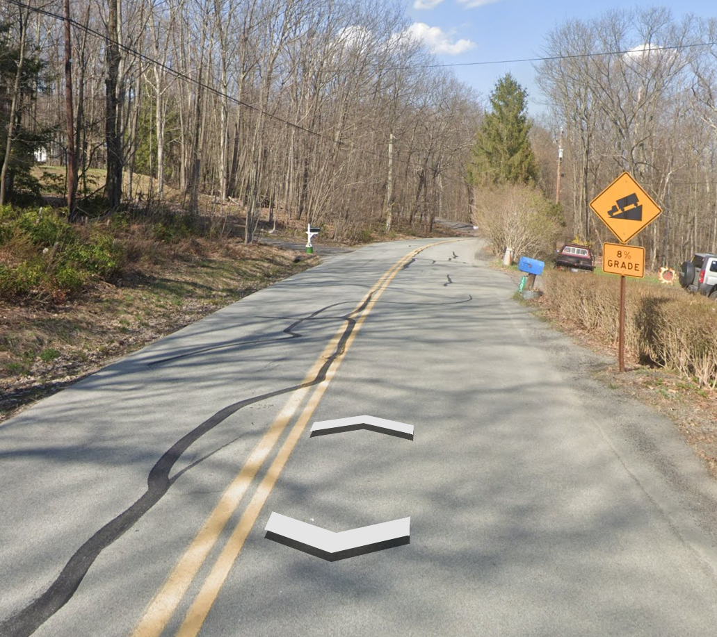

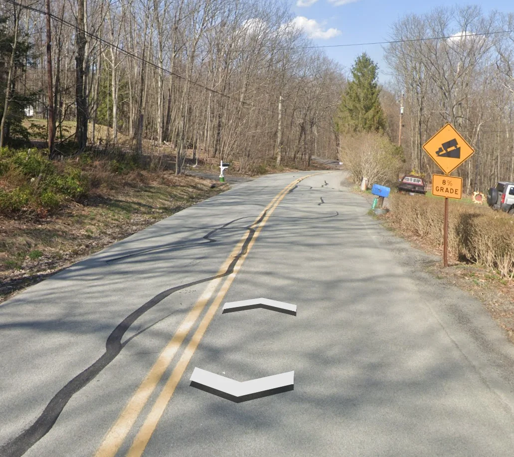

Assuming yours is an auto trans, the 5.13's are perfect with 285/75's... my daughter's Islander can finally maintain highway speeds and accelerate/maintain up long grades. I'm only at 1500' ASL here by my house in PA, but we have some steep grades all around up (6-8% are common when leaving/coming back home from "the valley" below us).
The above screen shot from Google Earth shows the "8% grade" sign (one of many) that is the one we drive by the most often when heading to town. It's affectionately known as the "talking sign", since it corresponds to when we'd be able to shift out of 2nd gear and could have a conversation (or hear the radio) again... :ROFLMAO: On 5.13's now, the JKU is much happier and can maintain 30-35 mph up the entire hill without having to run above 4500 rpm!
Yeah, I do have the automatic trans. The 3.8 wouldn't be in such ill regard if they had mated a different transmission to it I feel. They don't have grade signs on roads out here but it's very up and down and it can last for many yards and it's almost like a roller coaster. If I want to drive to Santa Fe in my Jeep, it's an adventure due to the incline and declines on I-25.
