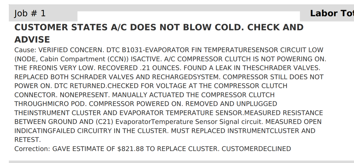

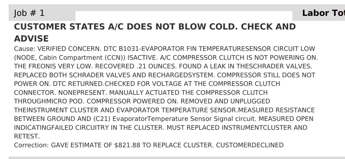

I am having an issue with my airconditioning blowing warm. Dealer said after recharging system, compressor had to be manually activated with micropod. They are saying replace instrument cluster, $850... Does this seem right? Anything to try? See attached pic. Thanks for the help
