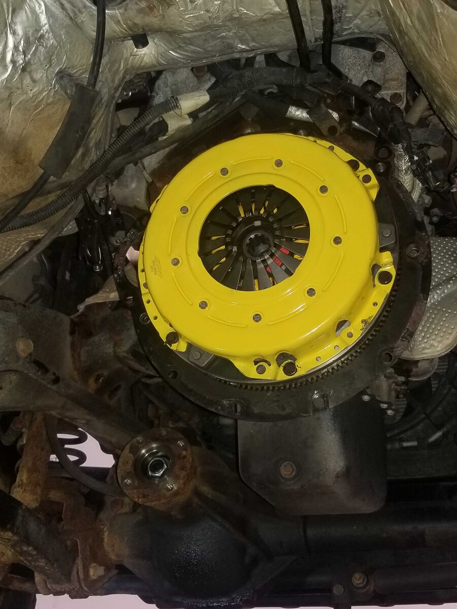

Ya, it is Saturday night. And you young kids are all out having fun (stay safe). Me, I am having a Home Brew, at home of all places. ( I digress) Has anybody put one of these B&M Shifters in their JK. I think it would marry with my ACT HD performance clutch. Pic of my ACT last yr, outstanding heavy clutch feel, it is not good for rock climbing. Cheers. 20191121_134745.jpg
