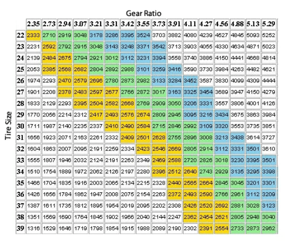

What will 4.10 gears do to my engine RPM's at highway speeds. Right now at 65 mph the tach is about 1800 RPM's. I have a 5spd automatic.
This chart is based on 65 MPH and a gear ratio of 1:1, on a manual transmission in 4th gear. Please NOTE: If you have an automatic transmission your RPM will higher due to slippage in the transmission and the torque converter. With an overdrive transmission your RPM in overdrive will be 15% to 30% less than indicated.
This is pretty accurate. My 2014 3.6 5-speed auto w/3.73 runs about 2200 or so at 70mph on 35" tires.
