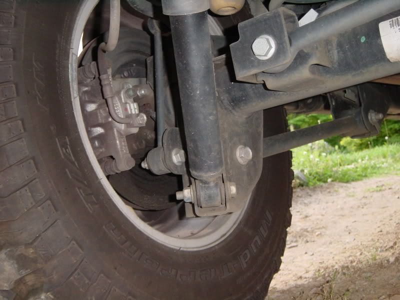

Seems like the JK/JKU utilizes rear shock mounts that hang well below the axle tubes. Anyone found a solution to raise those up out of harms way?

However, it seems with that solution that you end up with a shorter shock, which would mean less travel, right?
I suppose that depends on what you are adding bumps for. If you had 2" inch bump stops due to tire clearance not compressed shock length then you could potentially gain droop by moving the shocks mounts up. Having no experience withs JKs though I have no clue what is the limiting factor with 35s or 37s on any given lift size would be.
@Chris have you cycled the suspension in the rear? If so, what was the limiting factor?
Evo also makes a pair of raising mounts.

I didn’t install the lift, so I didn’t cycle the suspension. It makes me want to though, as I am curious.
What is going on above the upper shock mount?
There’s little room to gain anything there. The MetalCloak brackets would allow someone to do a budget boost and keep the stock shocks for bigger tires, little else I would think.

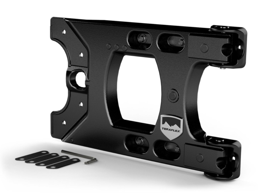

Take a look at the Teraflex Alpha HD. I was going to do the same as you with the AEV until I found this
It replaces the hinges with a heavy duty bracket assembly
