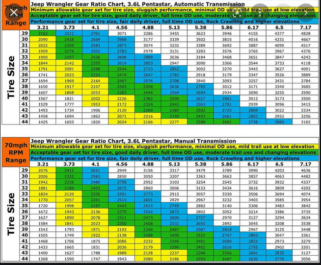

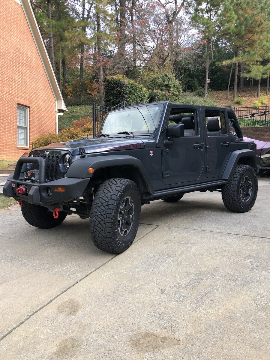

I put 2.5 full suspension lift and 35’s on my 2016 Rubicon.  I was immediately unhappy with the power. I am Upgrading to 4.88. The shop started out talking about 4.56 but when I suggested I might eventually got to 37’s, we settled on 4.88. Reality is setting in and I don’t think I’ll likely ever go to 37’s. Is it a problem to run 4.88 with 35’s?
