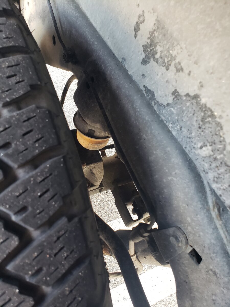

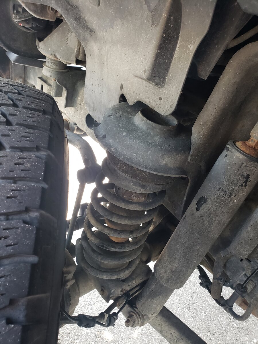

Hi guys, I know this gets asked over & over, but I need spacing help. I'm trying out some Toyo Open Country 33×12.5 on my stock 18" rims. How big do my spacers need to be without being excessive. I have 1& 1/2" lift (bought it that way) on my '16 Sahara. I do some light off roading & mudding, nothing crazy.
I know I need hub-centric spacers, but don't know the sizing needed...
Now I have the stock 255/70/18 so its like 9-10" wide
So if your new tire is 12.5 wide and the old one is say 10 wide it's only going to stick out on the back side about 1.250 to 1.5". Half of the width is going to be on the front side of the wheel.
If you want to be safe get the 1.5 spacers.
