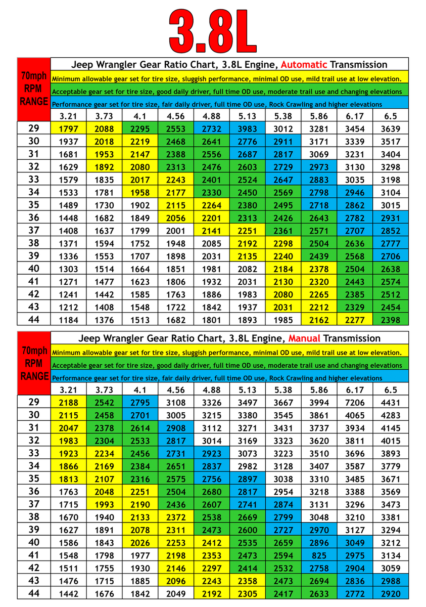

4.56 too much for 3.8 and manual?
<blockquote data-quote="spiderbobr" data-source="post: 447534" data-attributes="member: 22817"><p>Went to 4:88 in mine, along with a Detroit Locker and an Air Locker in front. I'm happy at 60mph. I figure those people can go around me on the highway. I'm in no hurry and happy.</p></blockquote><p></p>
[QUOTE="spiderbobr, post: 447534, member: 22817"] Went to 4:88 in mine, along with a Detroit Locker and an Air Locker in front. I'm happy at 60mph. I figure those people can go around me on the highway. I'm in no hurry and happy. [/QUOTE]
