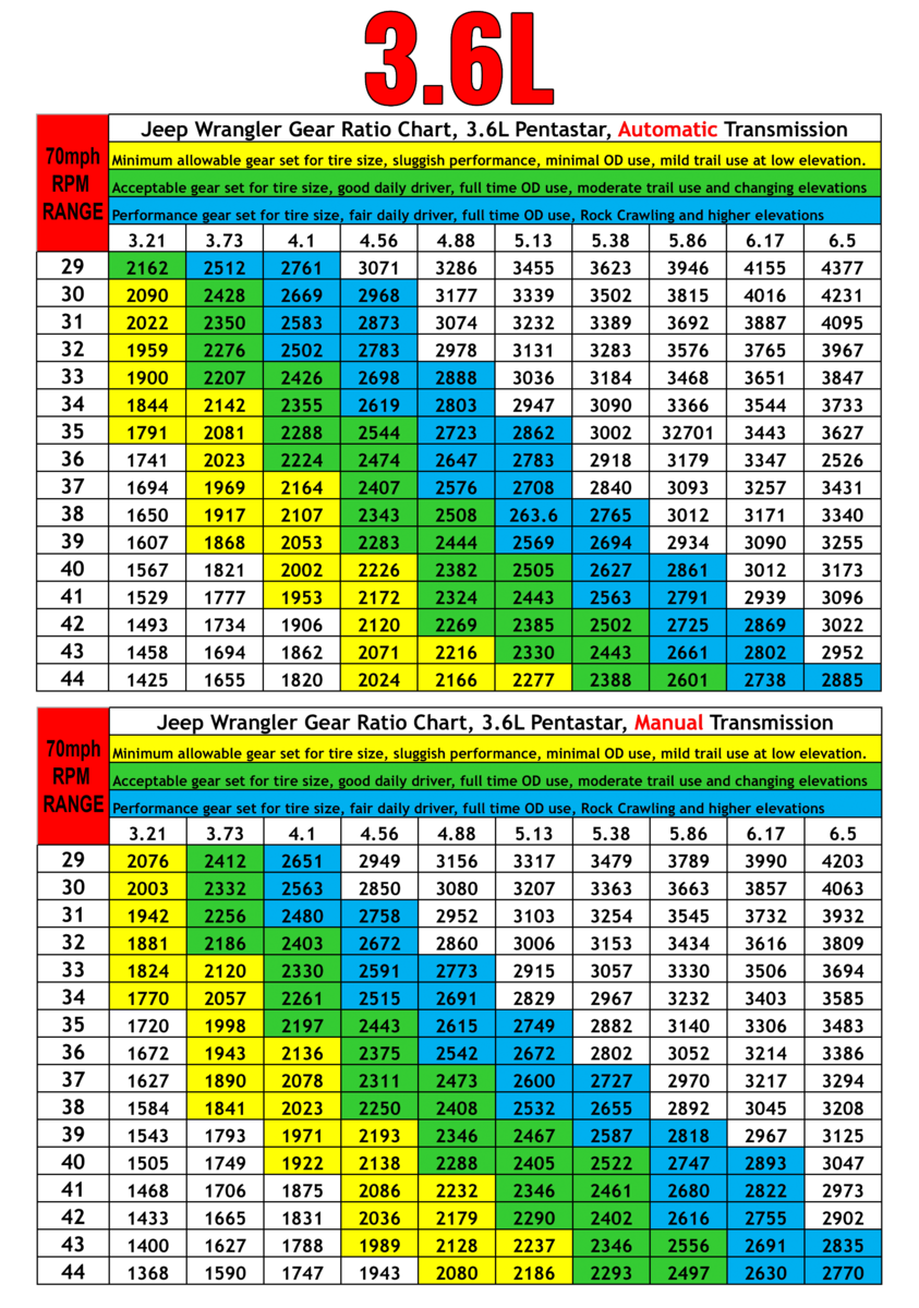

i just looked it up on the site you gave me , its says 3.21 rear axle ratio

Here's a chart for the gearing needed for a 3.6 on different size tires. 3.21's not gonna be great.
