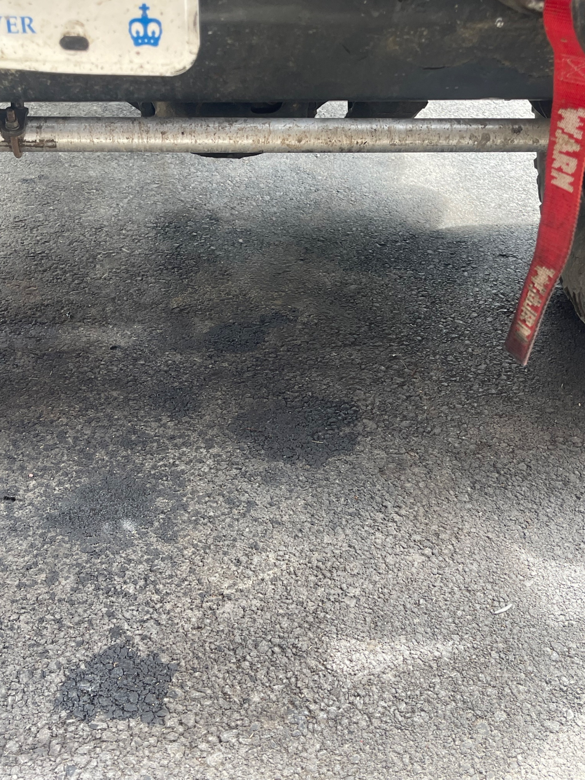

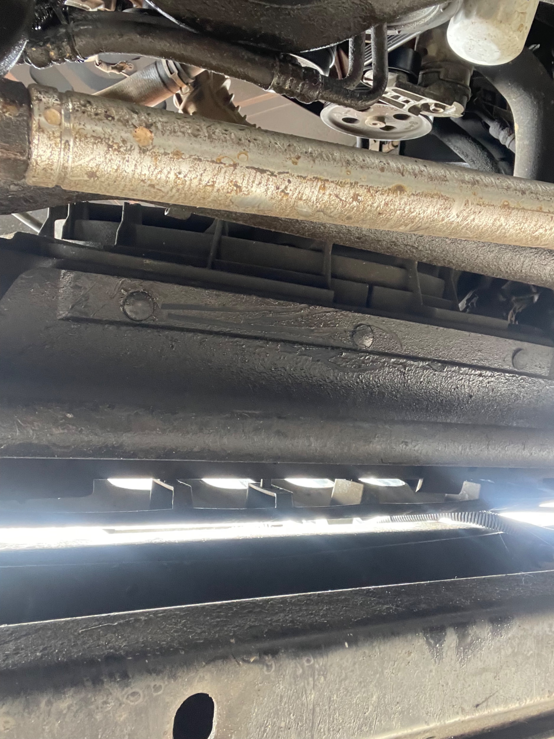

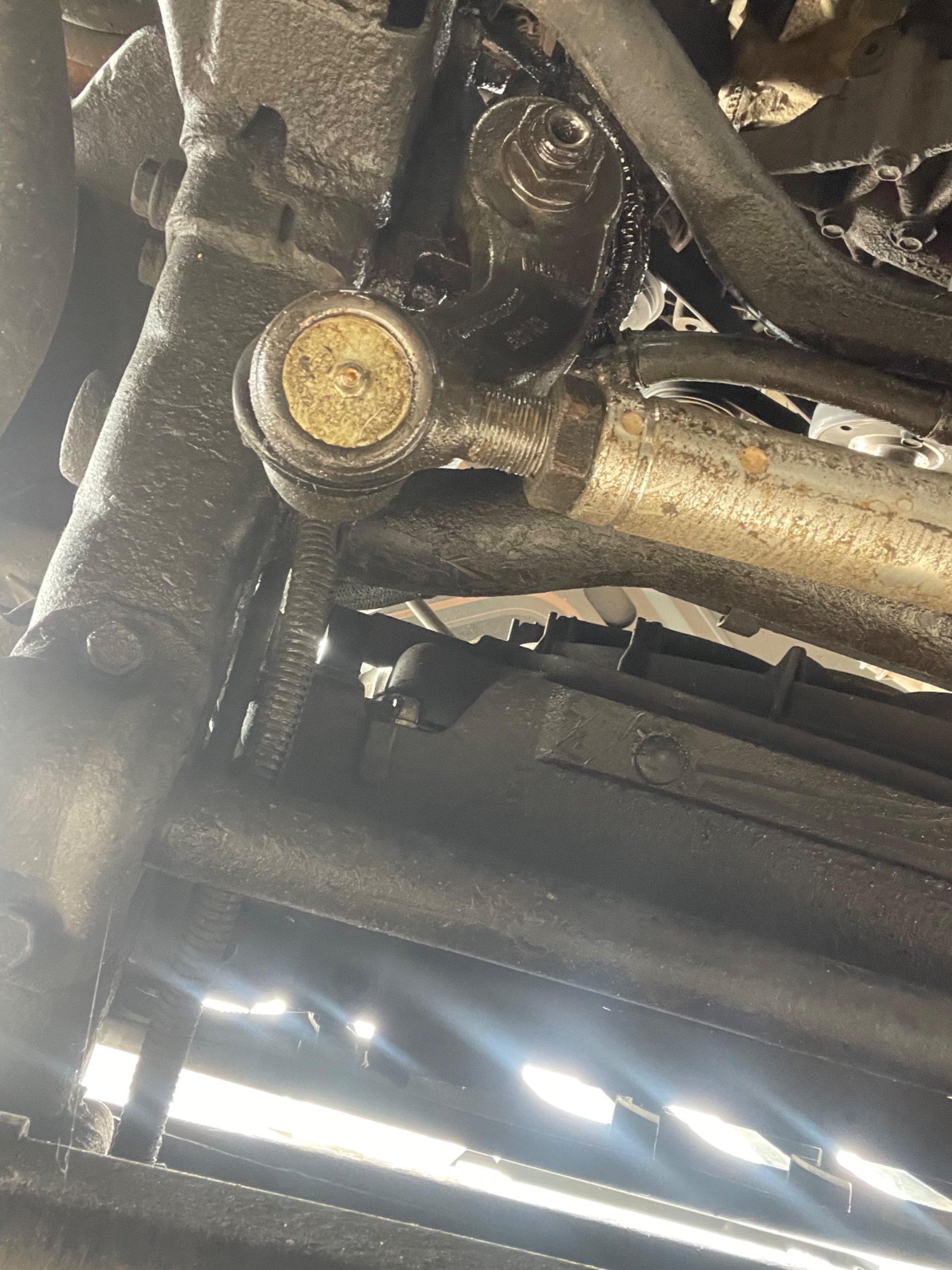

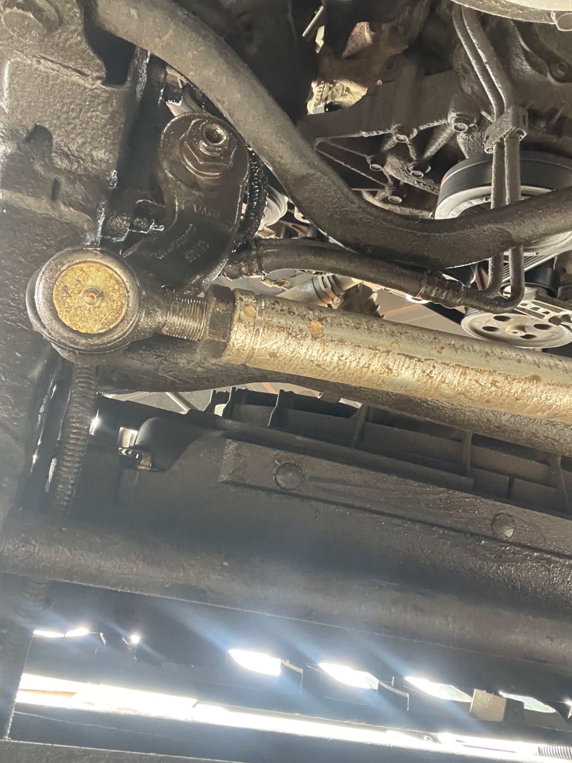

whenever I park anywhere I find a puddle under the exact same spot under my draglink. Was wondering if anyone’s had the same issue before.
Time for a new radiator. This is a common issue because of frame flex. You could do the spring mod to help alleviate that on a new one. I highly suggest sticking to a mopar one as all the aluminum radiators crack too.
I'm on my third radiator with my 2007. I think once this one goes I'm just going to send it out to be repaired and reuse it.
