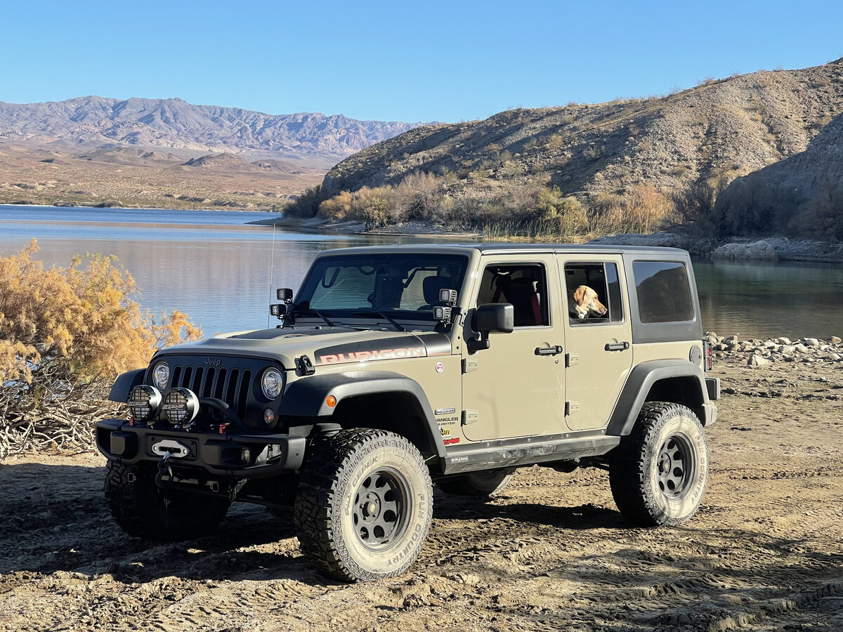

Also most of us don't really believe someone has a JK unless you post a picture of it, we need our picture Porn.

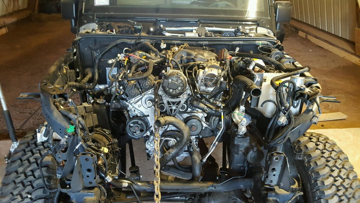

Thank you. I will posy some. It is in storage until after winter. I have to look back and get some while it was rebuilt. Thank you! The funny thing is I have lots of photos of others on my phone but just this one of mine during the rebuild. lol
