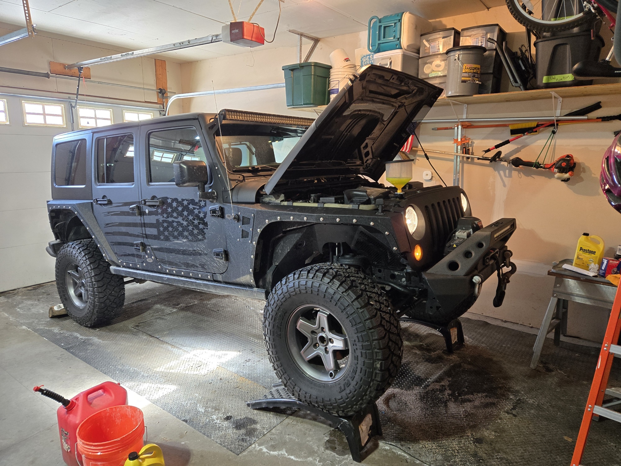

I just replaced the water pump and thermostat. Refilled the radiator and started it with the funnel attached and with coolant in it.
The temp got up to about 230F before I shut it off. The top radiator hose stayed cold and there was no heat in the cabin.

You need to raise the front of the Jeep up about 6-8", radiator cap off, engine idling, add coolant as it starts dropping.

Just tried it with same result. I checked the heater core hoses. The one one on the passenger side is hot, the drivers side isn't. I was planning on flushing out the heater core but its -5 outside. Would a clogged heater core cause the thermostat to not open for any reason?

Welp. Finally got it. There was an air bubble in the block somewhere. I cracked open the purge screw on the thermostat (while running). I dont understand how the air didn't just get pushed up through the radiator hose but it didn't. Haven't driven it anywhere yet, but the heat works now and the thermostat opens just fine.
