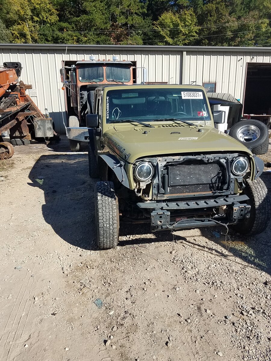

Hey y'all, I just started a salvage rebuild project for my 2013 JKU. I am planning on documenting the rebuild on my youtube channel, check out the first video and subscribe if you want to follow along!

Haha, thanks. So far the big problem I have found is po6dd code, looks like someone tried oil pressure sensor, "oil flush" at dealer, oil pump and control valve..... I just put another oil pump and control valve solenoid in for fun and have to do oil filter housing which came with a new oil pressure sensor so if replacing those 2 parts and using a factory mopar filter don't fix CEL I will be off to chasing wiring and possible ECU.

Nope, P06DD is oil control solenoid stuck OFF. Turned out to be a junky oil filter housing causing poor oil pressure readings, upgraded to an aluminum 2014+ housing from Dorman and problem solved. Just took me a long way to get there haha.
