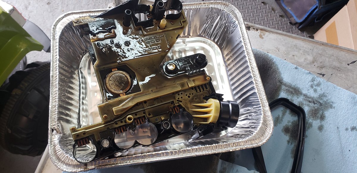

I forgot to update this, I picked up the Jeep from the dealer and took it home. Ordered a Transmission Speed Sensor Module Plate, filter and fluid and a friend and I took a coiple hours swaped everything over and the cars been driving perfectly since. We've driven it a lot also probably 1500 miles of mountain winter driving and it's been driving perfect. The fluid was pretty gnarly so I'm going to do a drain, fill and filter at the next oil change and then every 10k for the next 30k miles just to be safe.

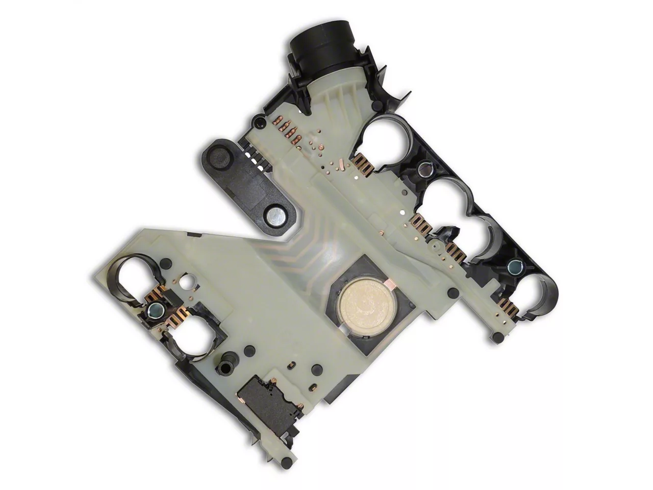

Picture was the failed unit, got a dorman unit from autozone with some coupons it was only $220. Same Mercedes Benz stamps and parts numbers as the one I pulled so I think the doorman unit is oem. The dealers I called all quoted me around $700 for the part

Also, that's good info about the Dorman unit. I wouldn't be surprised if Dorman is an OEM supplier to FCA.
Yep driven it about 1500 miles over the the 2 weeks or so since I replaced it. The dorman one had MB stamps and the exact same part number
