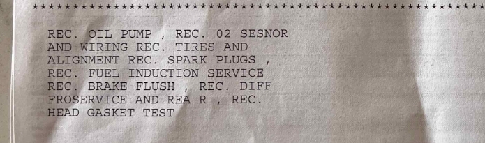

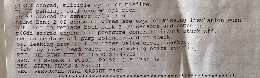

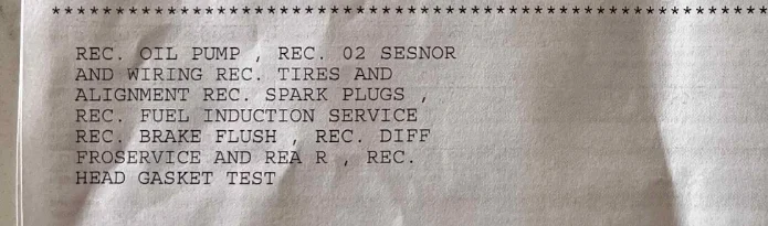

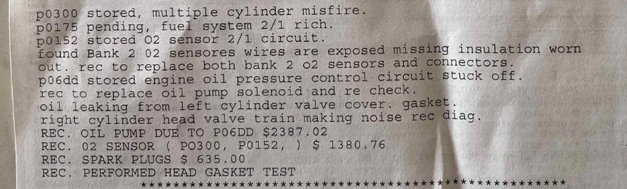

We both agreed to have it diagnosed at the dealership. The report came back that it needed an 02 sensor and lead on left bank catalytic converter and new oil pump. But it also said they could hear "right cylinder head valve train noise" that needs diagnosis. Otherwise known as the Jeep JK "tick".
Jeep extended the manufacturers warranty on a very well known cylinder head and valve train noise "tick" problem to 10yrs and 150k miles. Unfortunately that ran out last March for this vehicle.
I added up the average cost of the 02 sensor, lead to the cat and the oil pump. Which came out to about $1200 if done at a non dealership.
However the valve train noise has been well documented online. As a very common "tick" that was replaced quite frequently under warranty. But it included everything from lifters to cams on one or both sides. And since this vehicle is out of warranty I would have to absorb that cost.
