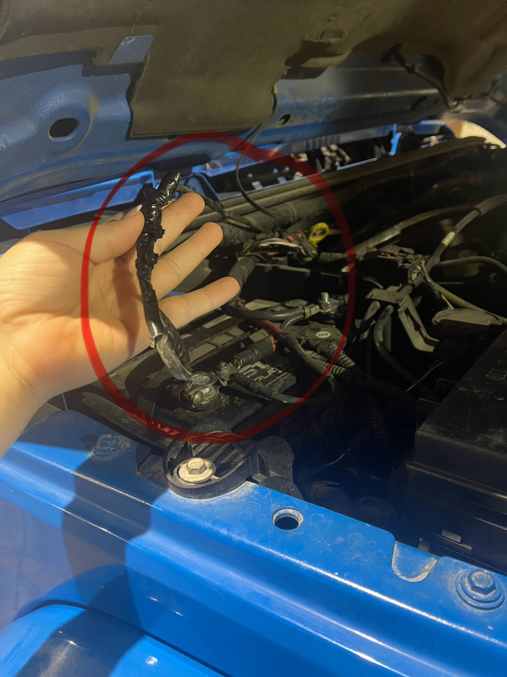

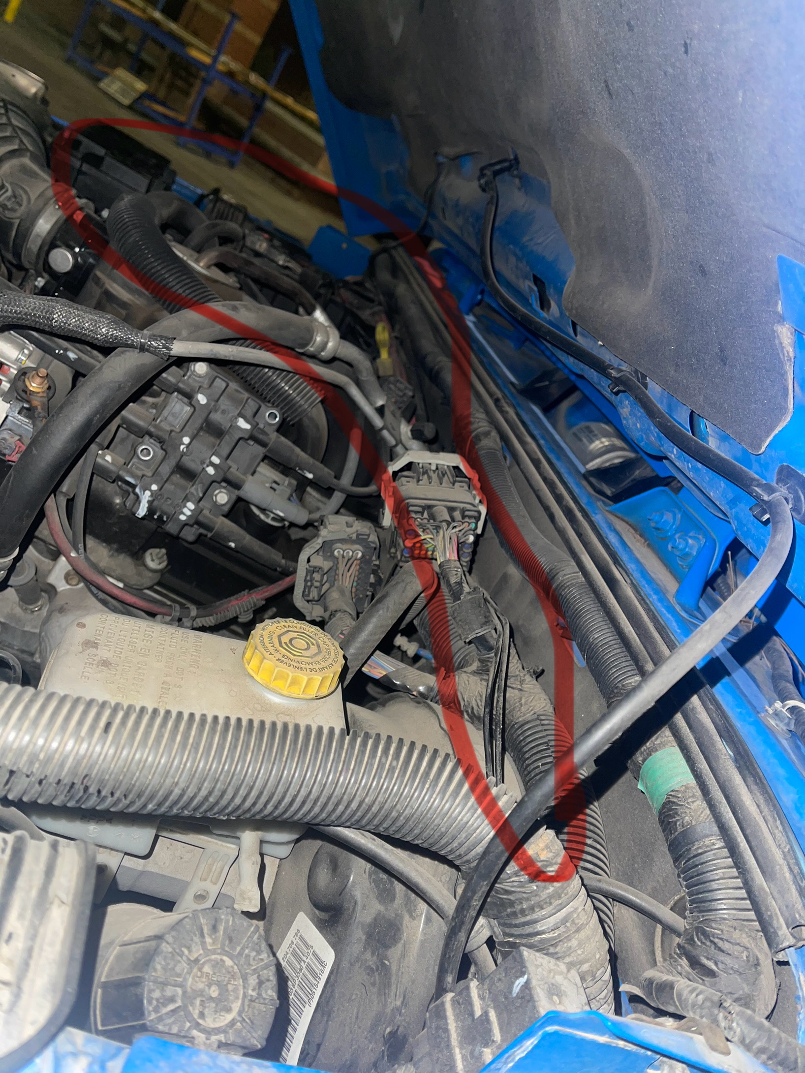

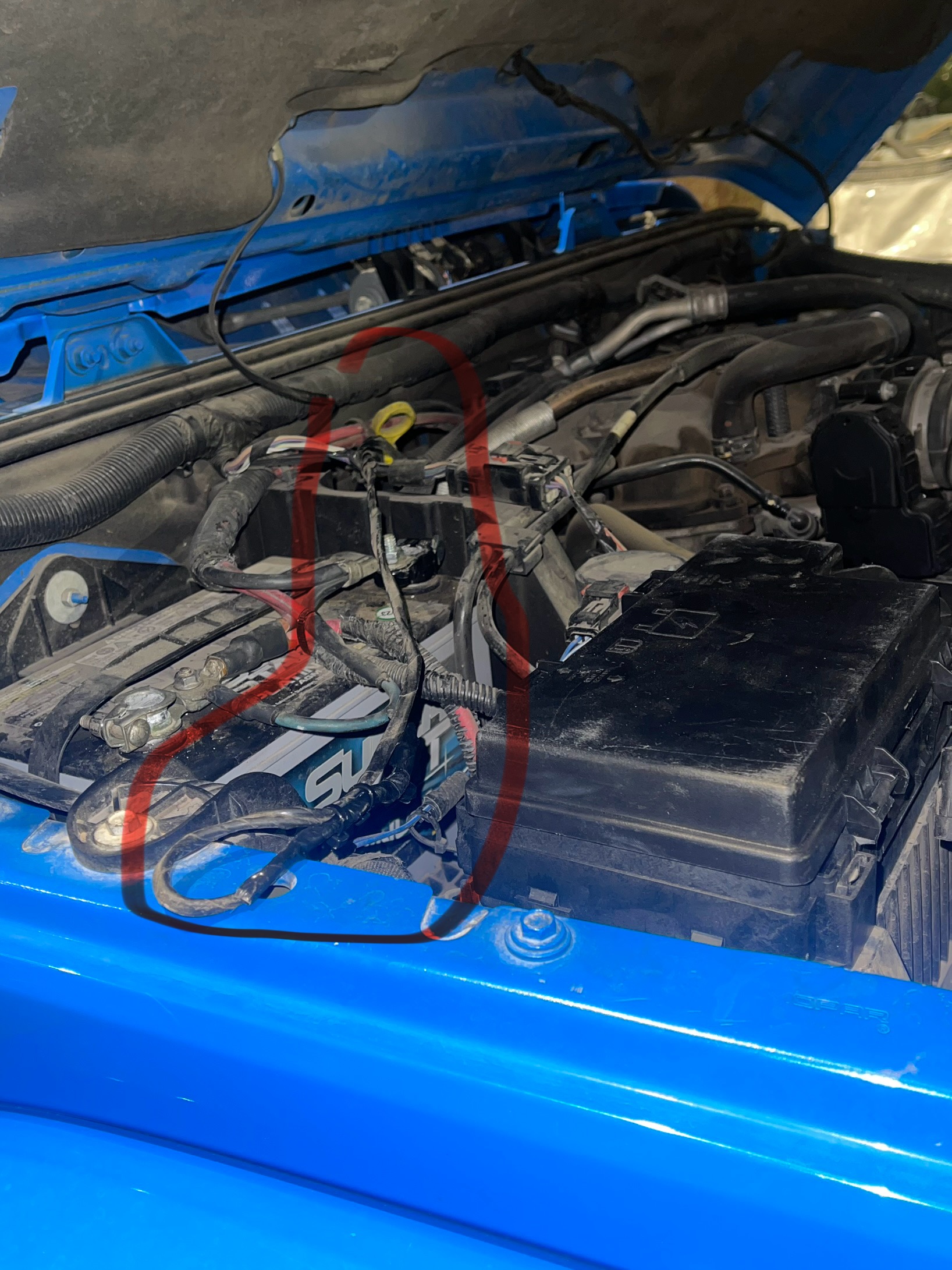

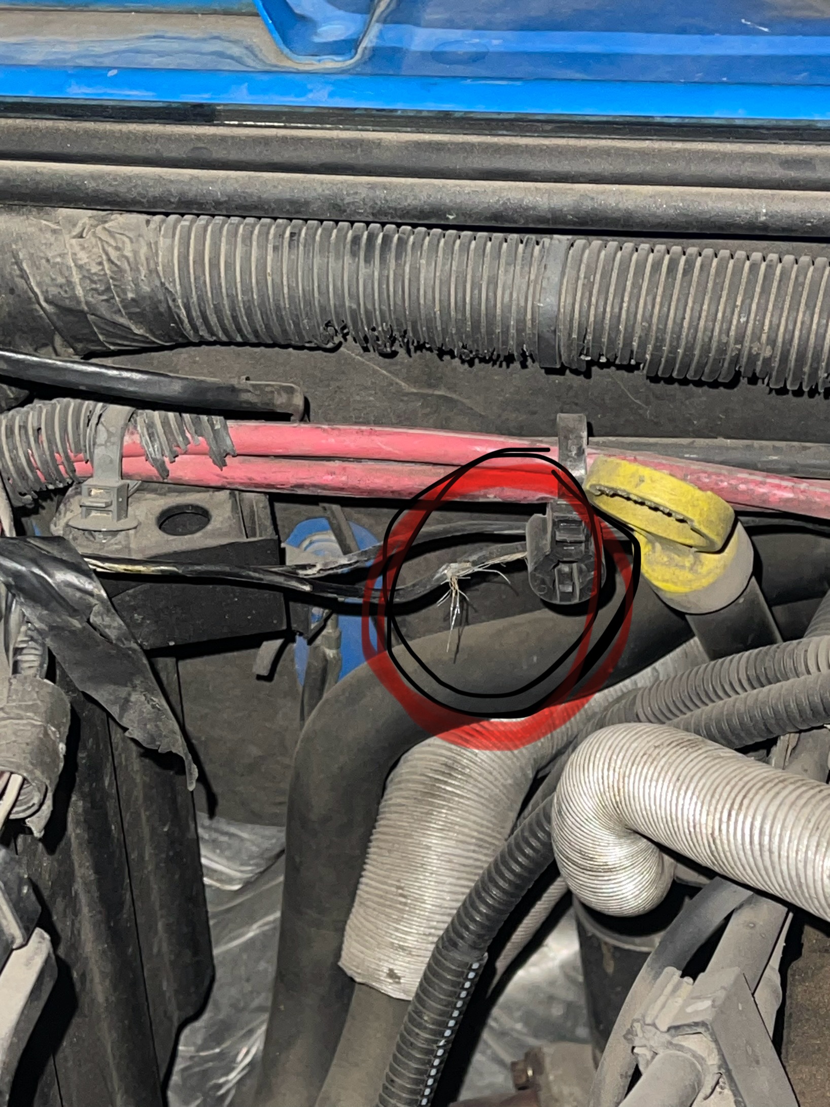

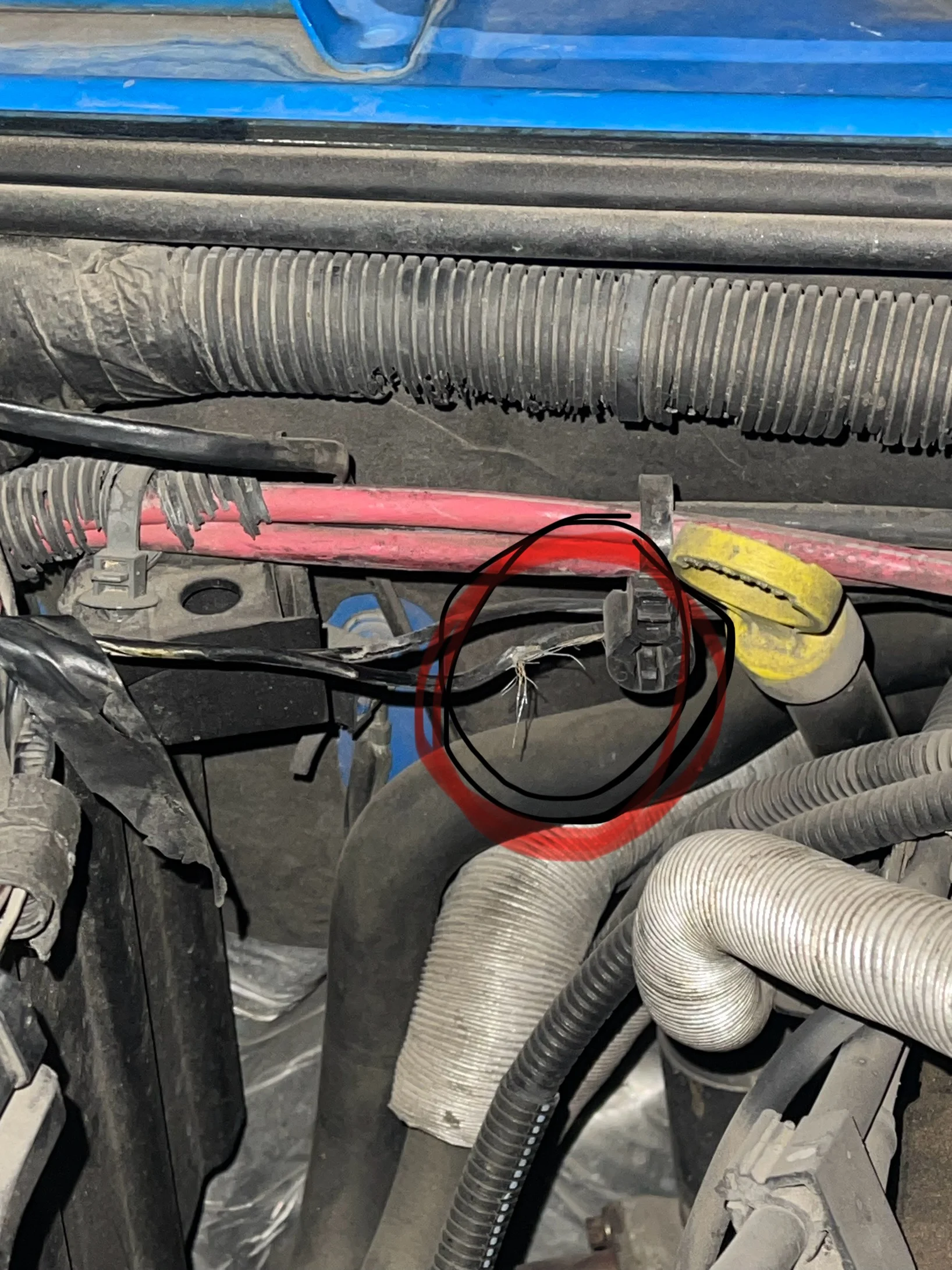

Problem Solved!!!
I’m glad I took the route of replacing a lot of things, because sooner or later they would of been a problem in the future since it’s a 2011 jeep wrangler.
My problem was a burnt wired that was from a tracking module/ secondary alarm system from a brand called spireon gps auto tracking device install by the dealership from where I brought the jeep. After I finish paying the jeep off, I forgot to asked them to remove it and had it with me since.
So the tracking module was tied into the main wire going into the TIPM. When the jeep failed to start that specific wire was getting very HOT! So the wire was cut from the tracking device and was repaired going in the TIPM. I believe since the TIPM was detecting something overheating being the wire it would failed to start due to safety
NOTE : DO NOT TAKE IT TO A DEALERSHIP! Take your jeep to your honest electrical mechanic, a dealership was about to charge me $400 for a diagnostic and if couldn’t find a problem they would STILL charge me.

Problem Solved!!!
Basically I was gonna get FUCKED in the get go.
