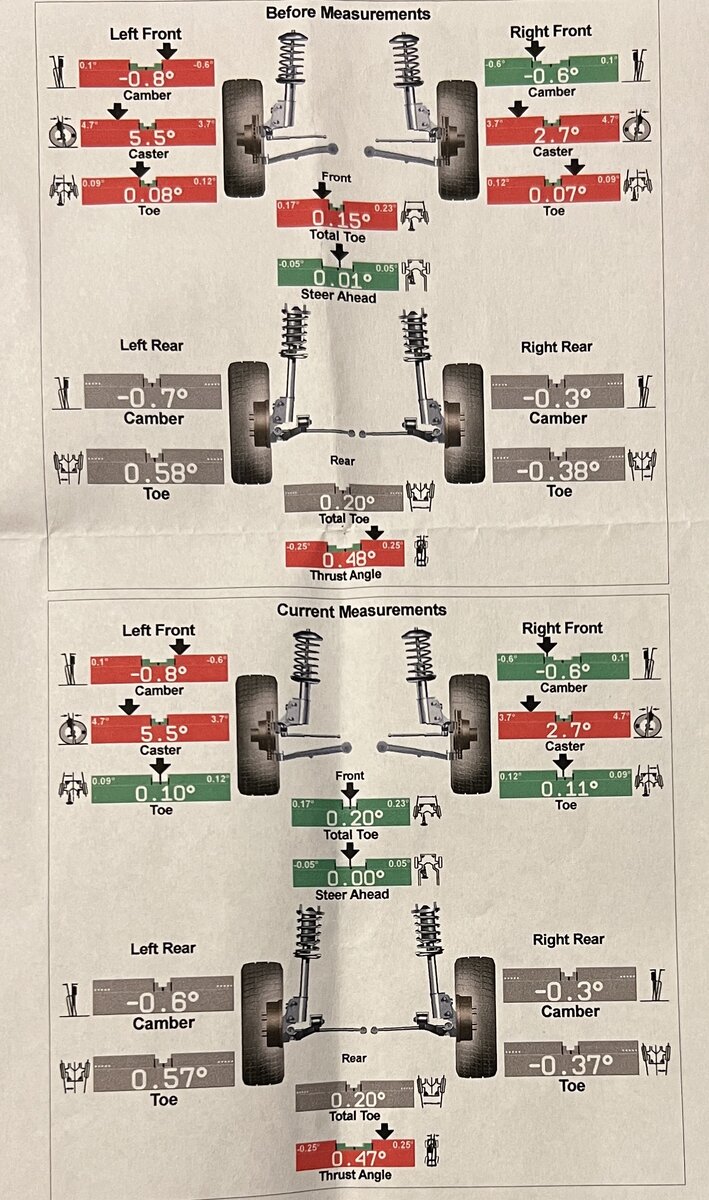

<blockquote data-quote="baylors" data-source="post: 454737" data-attributes="member: 24444"><p>This is what it's set at now. I have an appointment on Jan 10th with a different company. They did say that it's possible something is bent based off of this.</p><p></p><p></p><p>[ATTACH=full]123462[/ATTACH]</p></blockquote><p></p>
[QUOTE="baylors, post: 454737, member: 24444"] This is what it's set at now. I have an appointment on Jan 10th with a different company. They did say that it's possible something is bent based off of this. [ATTACH type="full" alt="8771B6DC-E886-43C8-A05B-712CF37622BE.jpeg"]123462[/ATTACH] [/QUOTE]
