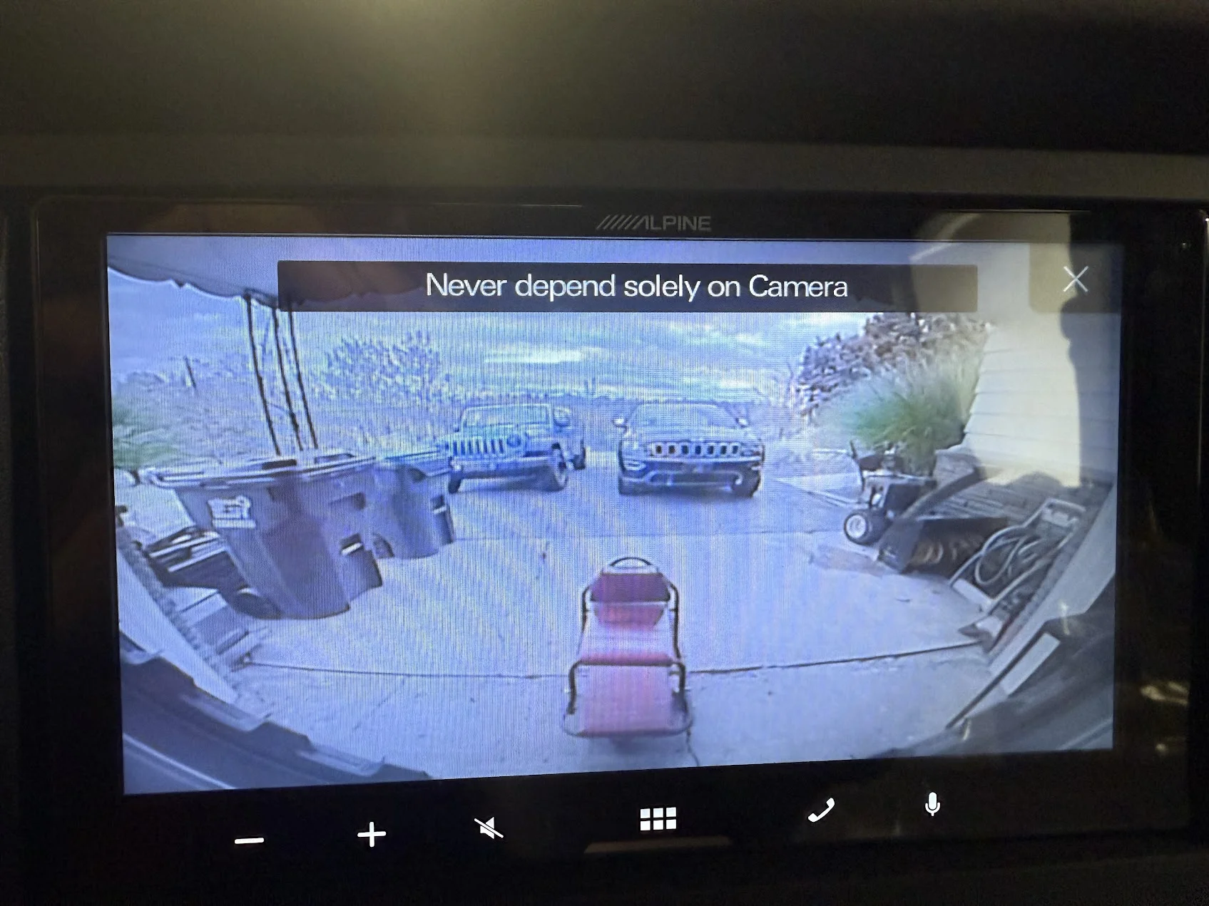

Here's a bad photo of the screen while I was adjusting the rear view camera (I put it inside the new spare tire mount I made and wanted to see how much better a FOV it had). It's plenty clear in full sun, at least for what I need it for. I liked how shallow the mount was (since it doesn't have a CD player, it's about 1/2 the depth of a traditional receiver), which made installation and hook up super easy. The GPS antenna really does help with signal acquisition, especially in the hills here (according to Alpine, the antenna works in conjunction with your phone GPS for higher performance than either alone).

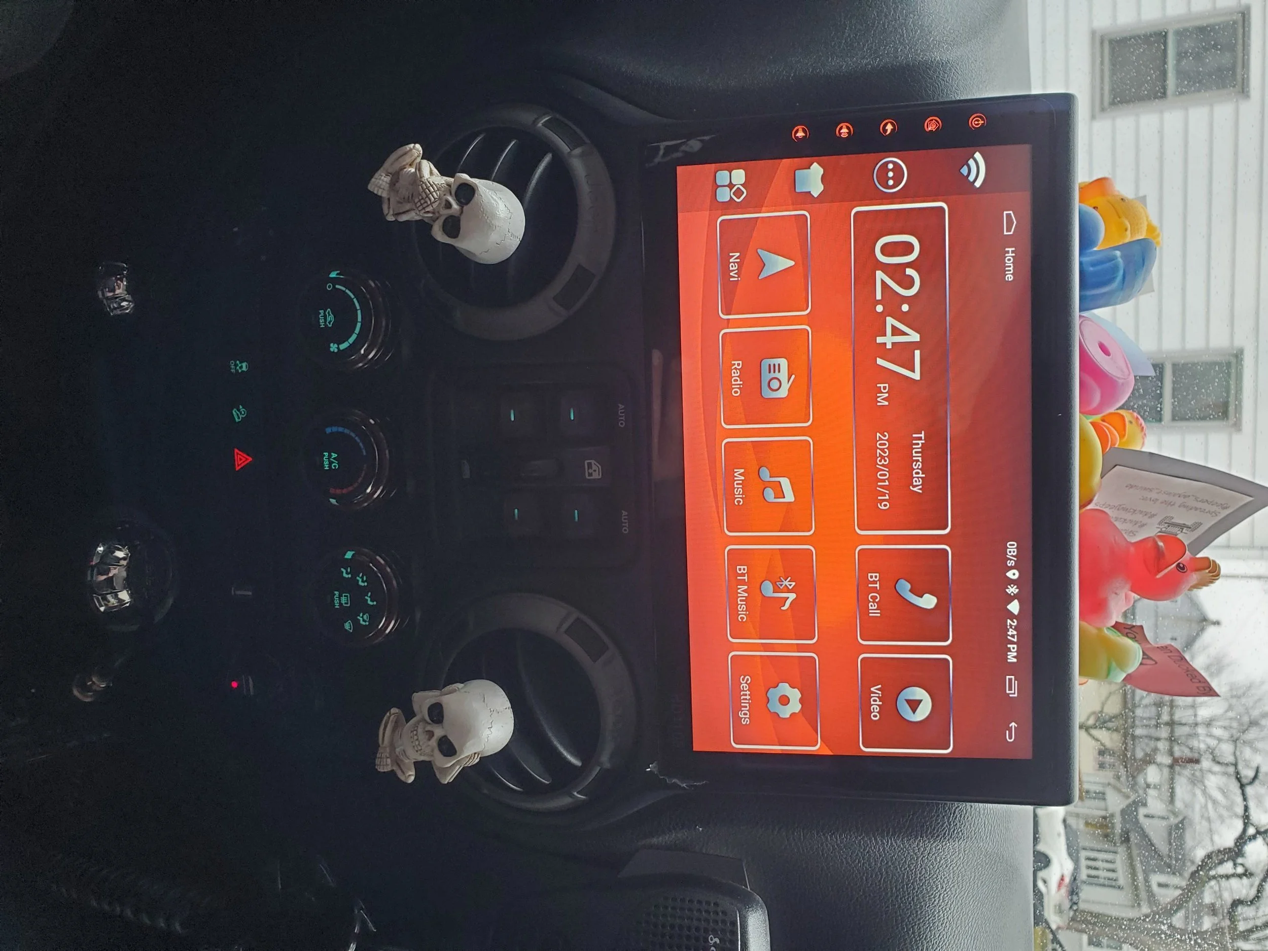

I went with an Amazon Chinese radio. It doesn't have a knob but I can use my steering wheel controls. It has backup camera, GPS, option for subwoofer, and inputs and outputs for audio/video. You can link it to your phone to mirror your phone. It has option for internet if you want to pay the $10 from a cell carrier or you can hotspot it. It also came with a dash kit. If I remember correctly, I paid like $360. Still working great.

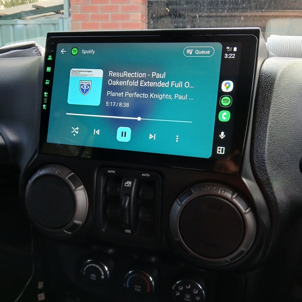

I also went the chinese android route. For what its worth, a proper Alpine unit will obviously out perform this thing in every way but at 4x the cost plus all the fitting kits, you can understand why i had to swallow my pride and go this way.
The key to getting them to function non-laggy is to buy one with the latest version android system on board and the most ram/rom you can get. The 2gig/32gig units are the cheapest and generally the ones everyone complains about being buggy. So far I have zero complaints about functionality, speed and usability. They can also be modified with different versions of software and interface but quite honestly I havent bothered, as i pretty much just use it in Android Auto mode. Its also got the most aggressive and fastest Bluetooth connection ive ever seen lol

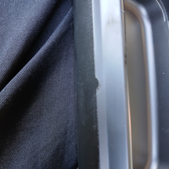

Worth noting that whilst it was "plug and play", there are still some things that need to be hardwired but dont affect basic functionality, and also some slight modification/clearancing required. That said, if you can remove the inlet manifold on a Pentastar to do spark plugs, this is definitely within your capabilities. Note that the provided instructions werent worth the paper they were printed on.

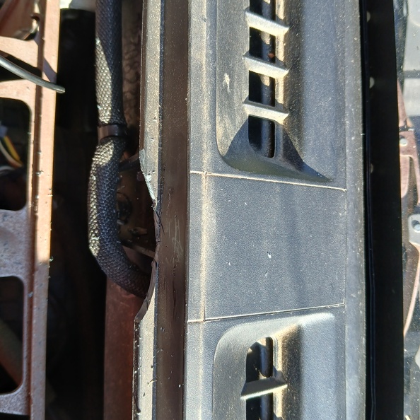

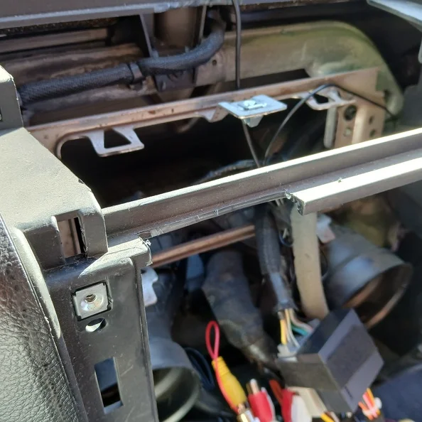

Had to clearance the cross bar behind the radio to get it to sit flush. The kit i had required the headunit be screwed to the fascia before the fascia was installed so a fair bit of trial and error was involved

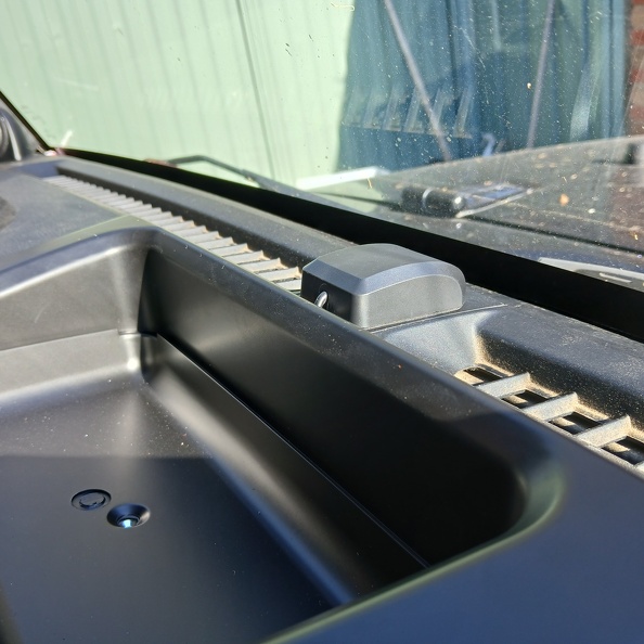

Also had to clearance the upper dash frame and the coin tray to get the GPS antenna to sit where I wanted it
No volume knob however the volume controls behind the spokes on the Jeep are honestly one of the best steering controls ive ever experienced. Its as simple as selecting the right CANBUS protocol in the menu to get it to work which will program the buttons as per OEM. You also have the option to re-program each control after that and assign it to any function you want.
All in all its one of the few non-branded, chinese made things ive bought that I can say functions properly.
