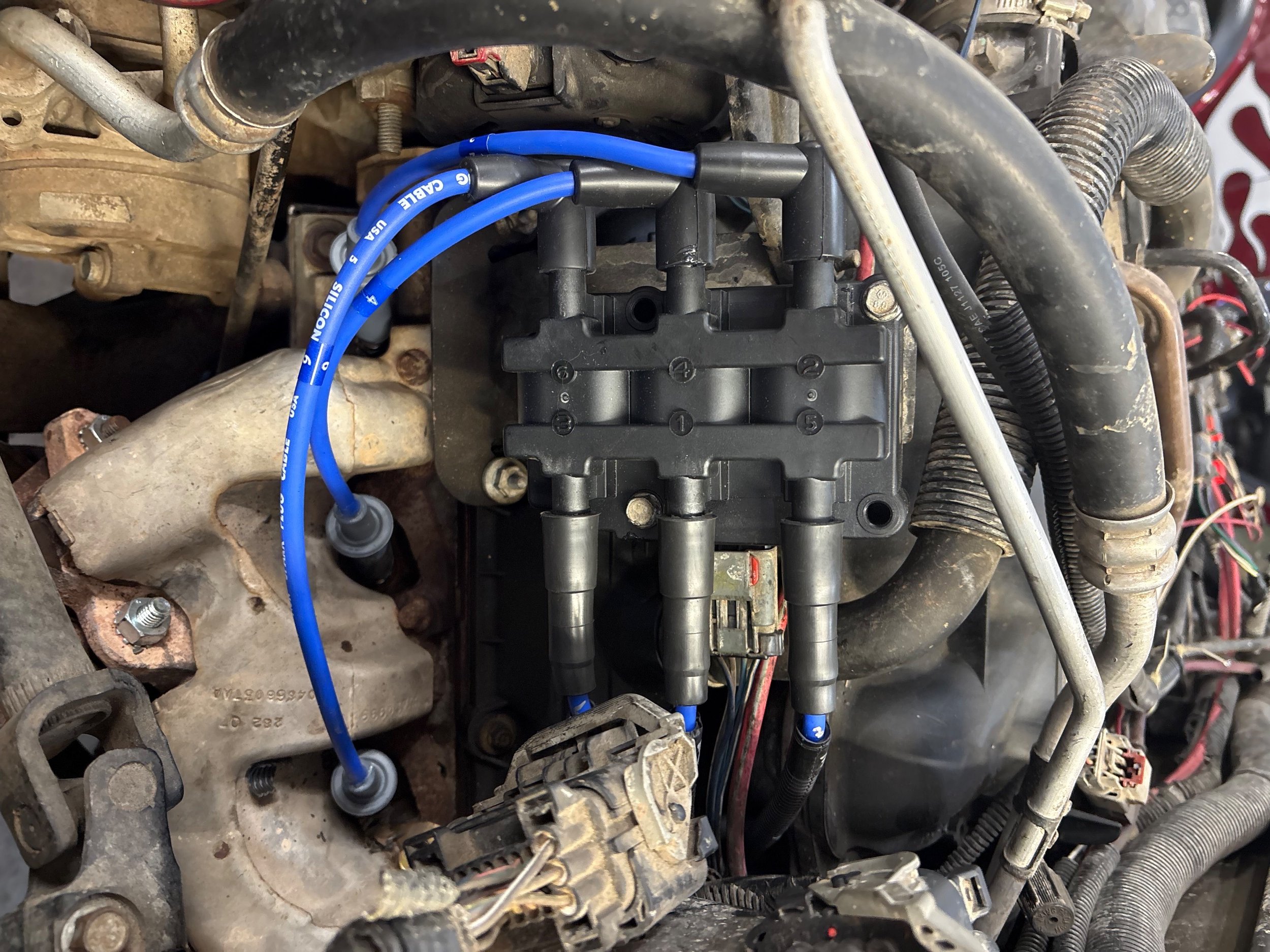

1. I replaced missing cat to manifold in driver side, and tightened cat y pipe.

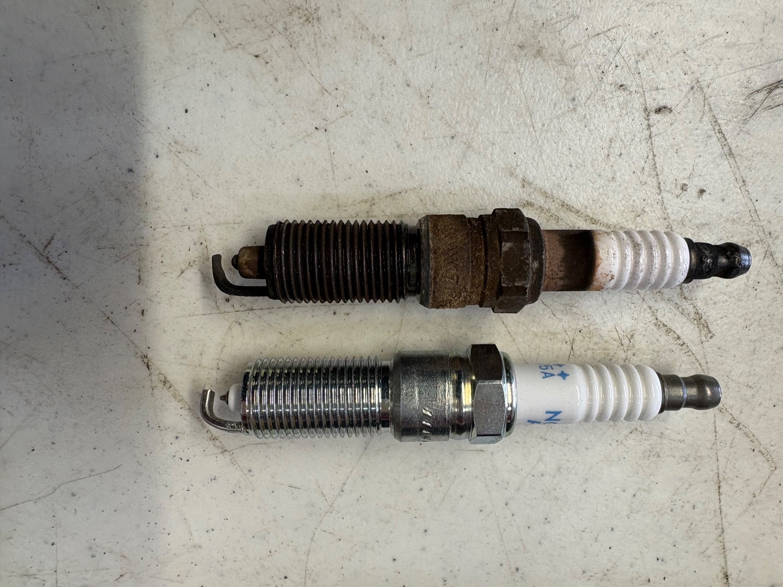

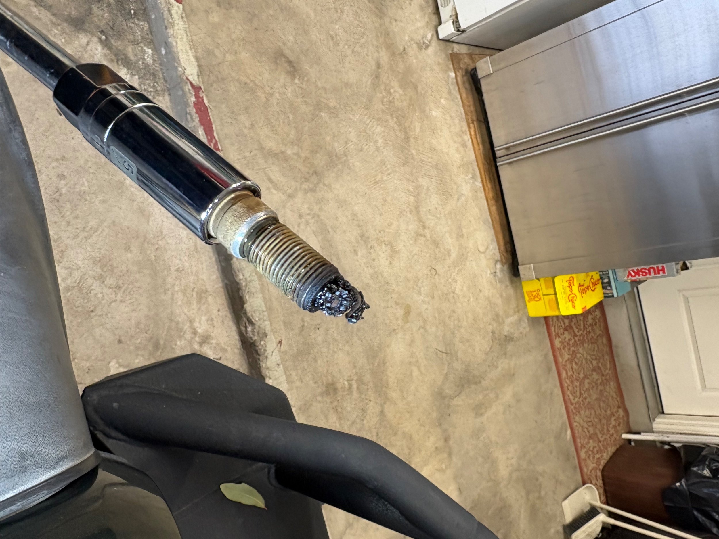

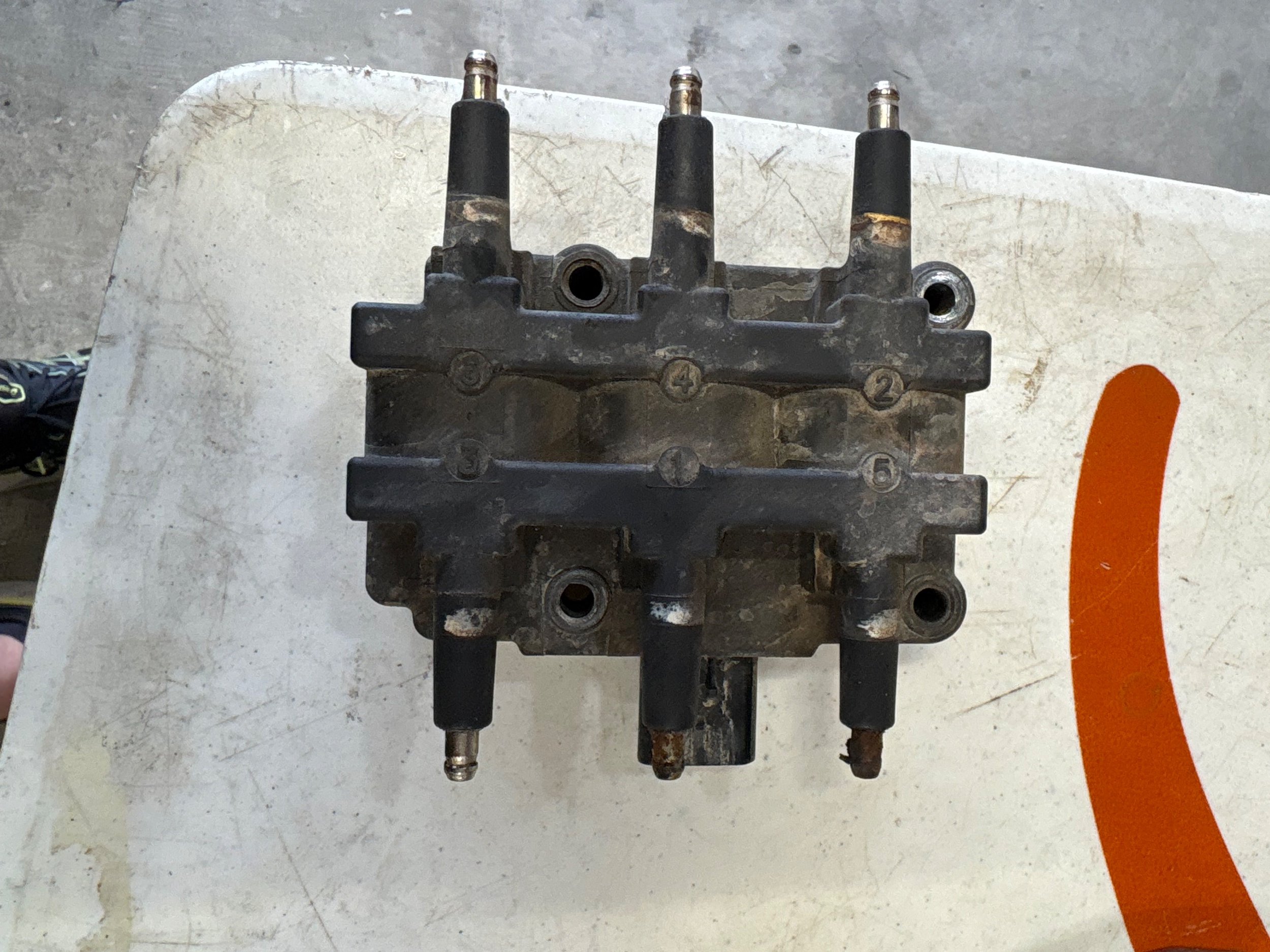

2. Tune up, new plugs, wires and Mopar Coil. Wow, 4 plug wasted, all of them were wow, 4 worse.
